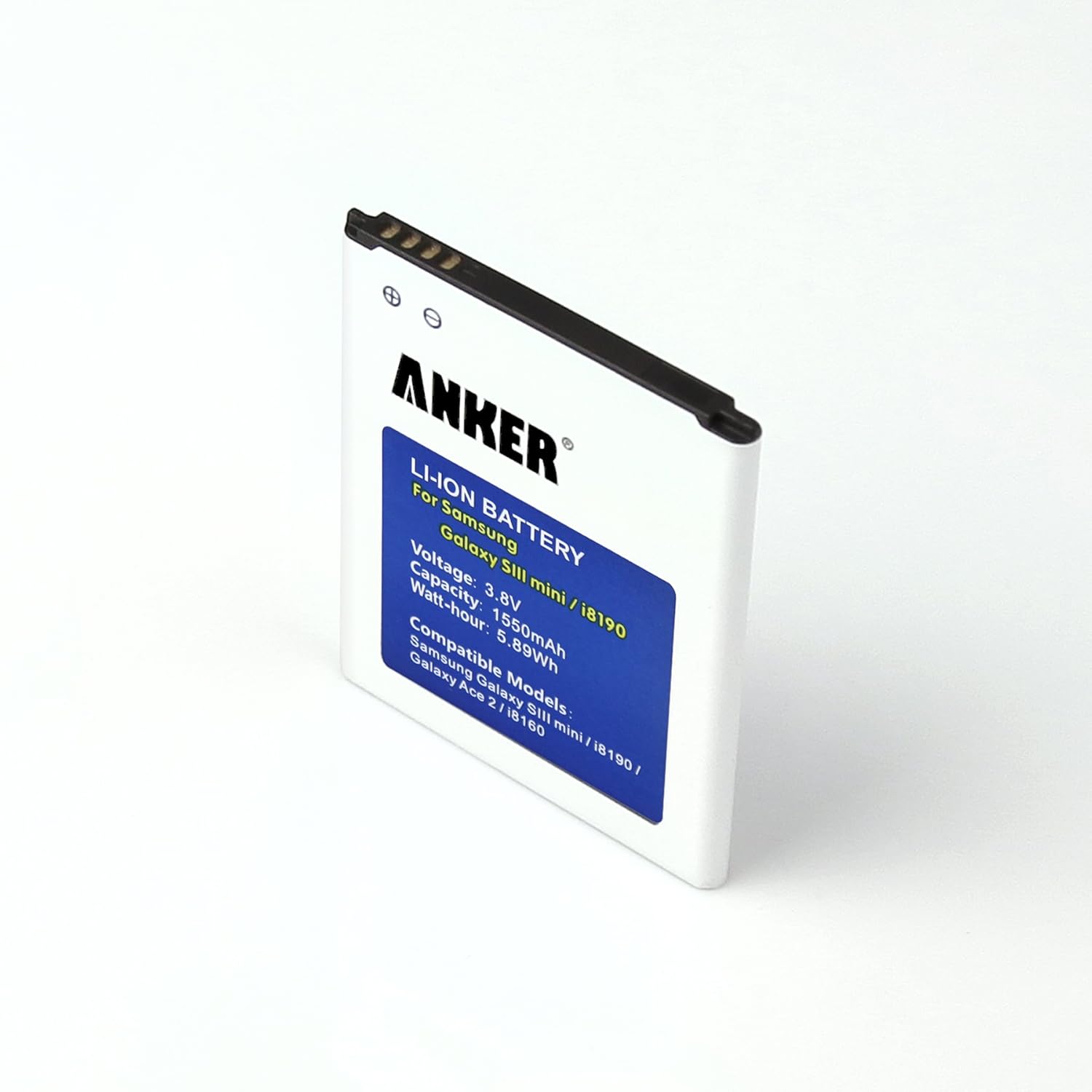

embarrassingly, the only site i found that actually lists measures is amazon, so e.g. this should fit:
Because the right number, the right placing and the right wiring of the contacts are important, too?
ehm, i assume your question mark is ironic. to ask genuinely: which number, what wiring? by placing, you mean where the contacts are?
purely based on the images of both batteries, the dentures and placement of contacts could work, right? the voltage is comparable, the capacity (mAh) is another matter. right?
so who else has looked (must be loads), how and with what results?
thanks!
As you can see, that Anker battery has 4 pins:
The original FP1 battery has 3 pins, just like the generic Huawei battery from above.
No, I just don’t have much insight in this case, so I’m rather cautious :wink: .
These would just be my generic concerns apart from a fitting size … There are batteries with a different number of contacts, so the number is important. Where exactly they are placed and with how much space between them may differ, too, so that may be important. And which contact serves which function (sorry, no electrician here) should be important, too, that’s what I meant with wiring, I don’t know whether there is an established standard for that.
The working battery @HermannMeuth found has 3 contacts on the right (labeled) side.
https://electropapa.com/media/catalog/product/cache/2/image/700x700/9df78eab33525d08d6e5fb8d27136e95/5/0/500_1456142906_akku_huawei_hb5n1h_1800mah/electropapa-li-ion-akku-1800mah-3-7v-f-r-handy-smartphone-telefon-wie-hb5n1.jpg
The battery you linked to has 4 contacts on the left (labeled) side.
To me that seems to be a significant difference, so I would be cautious.
