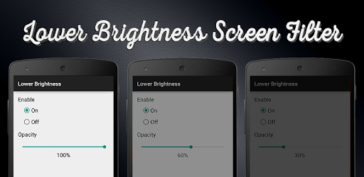

I too find the minimal brightness too bright. I found this app that adds a black layer above the apps you use.
It’s easy to use and does the trick while our complaint reach the Fairphone team :wink:
