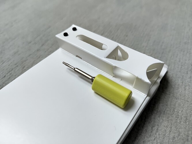

The FP6 card holder, lanyard and finger loop each already ship with a Torx T5 screwdriver stub included in the box (as well as two Torx T5 screws that can ONLY replace the two externally visible, longer screws).
