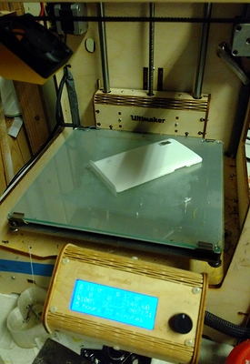

I’ve printed few tests.
The camera part is a bit problematic because if printed flat, you need to use support which is pain to get it clean afterwards. Though the inside of the case is printed nice which means the phone would easily snap.
If you print the cover standing, you will most probably have some overhang and you won’t be able to print things like the one @paulakreuzer suggested.
Atm. I’m working on flattening the back of the cover so that it can be printed without support while lying flat.
Also need to check the proper scaling. PLA usually shirks when printing so you need to adjust the size of the print. Usually I was scaling to 102% but thats too big. Printing without scaling is too small.

I want to try printing the case completely laying on it`s back but for that I will kill the small hump at the speaker area :smiley: Thats avoiding a lot of work removing the support-structure :slight_smile:

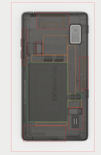

Picture 1:
Picture 2:
