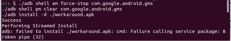

Hello. Thank you very much for the workarounf @Pilo11 . Sadly I cannot make it work: the phone reboots during the last command’s execution and I get the following message.
Success
Performing Streamed Install
adb: failed to install ./workaround.apk: cmd: Failure calling service package: Broken pipe (32)
The APK file I download is the correct one (Google Play services 22.02.21 (150408-428111784) (150408)) ~107Mb.
I am out of ideas, does anybody have a suggestion please ?
FYI when I look up the version name after this fail I get
$ ./adb shell dumpsys package com.google.android.gms | grep versionName
    versionName=22.44.16 (150400-487659498)
    versionName=22.02.21 (150408-428111784)
Thank you in advance for your ideas
