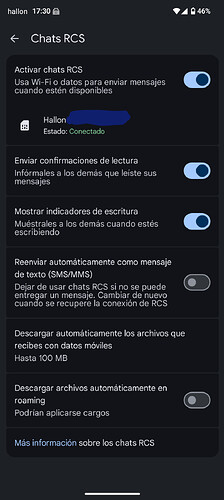

Jag har hallon, och det funkar helt ok. Har du RCS On? Jag har eSim, men det mÄste bli samma med kort.
Har du /e/os eller Android? (jag har Android)

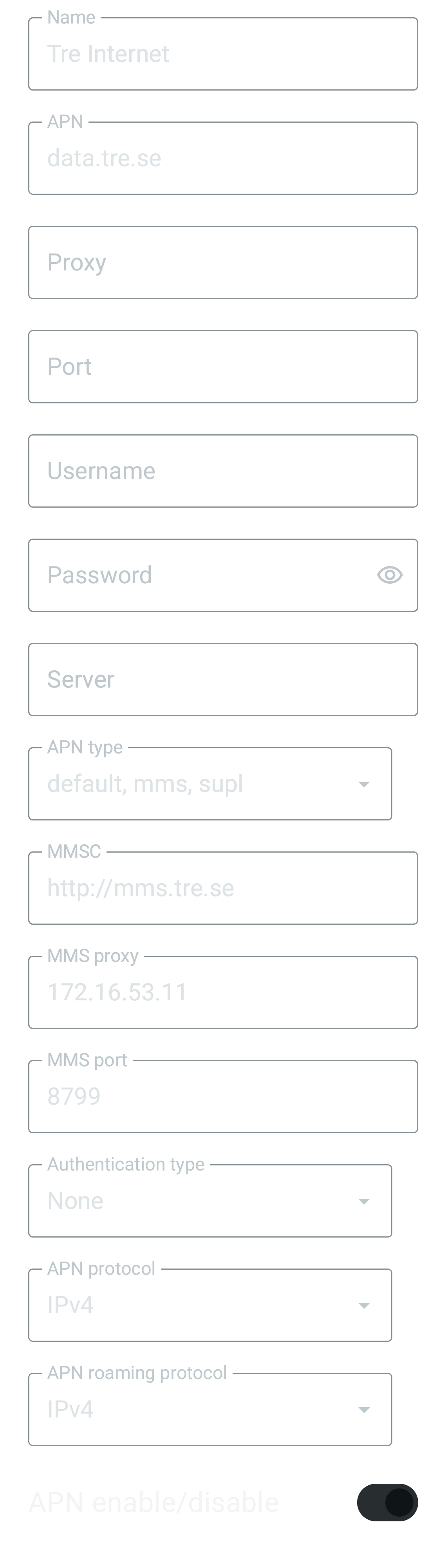

Jag har samma problem fast med Tre. Har suttit med supporten i 1h, och de löser det inte. Vi skapade en ny APN men det löste inte problemet.
Jag har försökt att ta bort MMS under APN typ. SĂ€tta bĂ„de IPv4/IPv6. Men inget fungerar. Testade för skojs skull att skriva “websp” framför tre.se men det gjorde ingen skillnad.

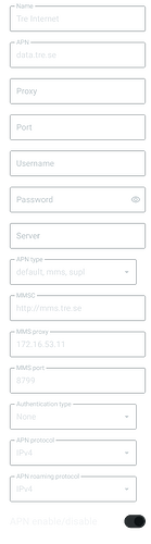

Jag har hallon (tre nÀtverk) RCS var helt okej. MMS utan RCS har jag provat inte, men jag tror det skulle bli ocksÄ okej. HÀr Àr min APN:
Det Àr samma som mina men mina funkar inte.

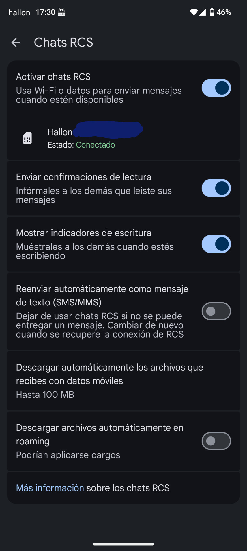

Within the Google Messages app, message settings, RCS, is it enabled for your number and connected?
Is it not working to anyone or only towards iPhones (those don’t have RCS in many operators)
(and sorry my settings are in Spanish but I guess you get what I mean)
Totally ok. Mine is in English :slightly_smiling_face:. Yes, my number is connected.

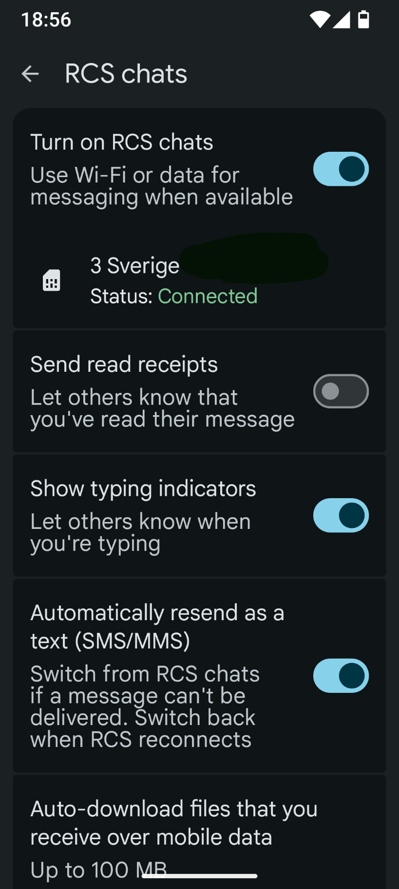

Is the other person on android or iOS? Does it show the RCS (arrow with lock symbol) or Sms logo? That can also be a factor. I have rollback to sms/mms disabled If it makes any difference

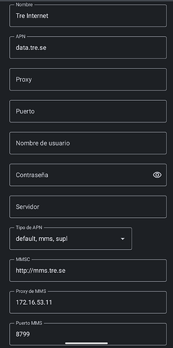

EDIT: I tried and it was stuck and checked my configuration and what hallon said, my MMS proxy was wrong, it had an IP instead of mmsproxy.tre.se that solved the issue for me @o2cui2i give it a try. @The_Door check that your proxy is provisioned correctly
Thanks. I guess I’ll have to check with my provider, right?
My provider has the configuration online, check in their website the APN configuration for MMS, mine was provisioned automatically with wrong MMS proxy, maybe you have the same issue.

I’ve tried both Android and iOS users. It’s the same. I also have the rollback enabled. It’s frustrating
I’ve tried both IP address and mmsproxy.tre.se, but none of them will make MMS work :face_with_raised_eyebrow:. The little “clock” or whatever it is, shows up directly under the image in the message.

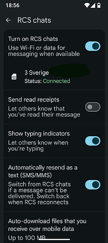

Just to confirm RCS does not work either? Or only MMS?
Yes, really strange. RCS works. Only MMS not working.
