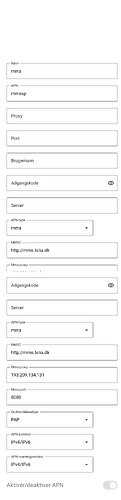

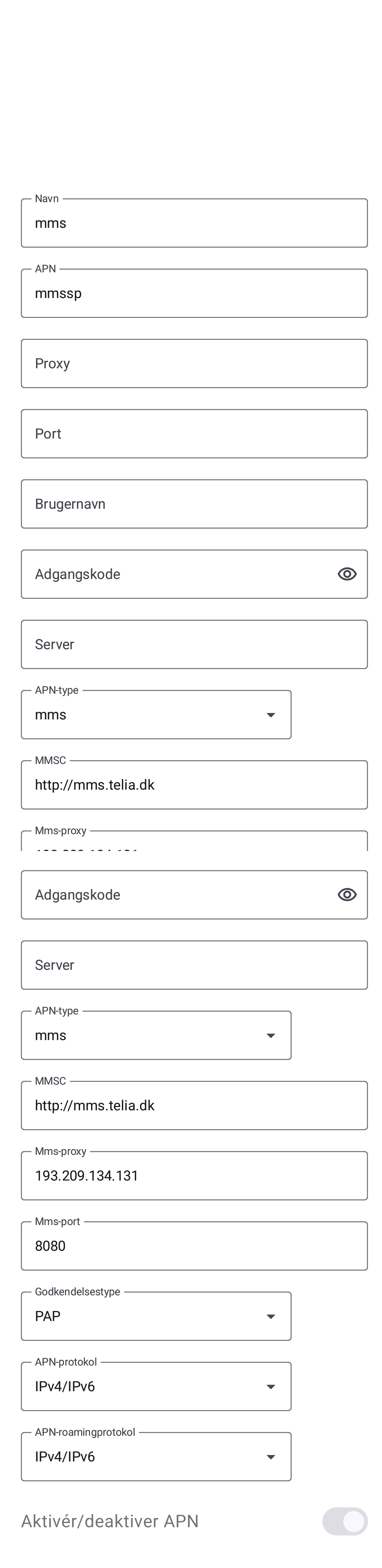

I cannot get the MMS to work with my FP6.
I have received several guides from my network provider, but the fields do not match the FP6 APN settings. The MCC and MNC fields are nonexisting in the APN on FP6. The network provider says they can’t help then.

I’ve read on, after the last reply from yvmuell. And I can confirm from Android forums, that it’s and Android 15 issue, the MCC and MNC fields have been removed with that version.
I’ve reported it as a bug to the Android team. And I’ll ask for a new guide from the network provider, taking that in consideration. Maybe a new sim card can fix it…

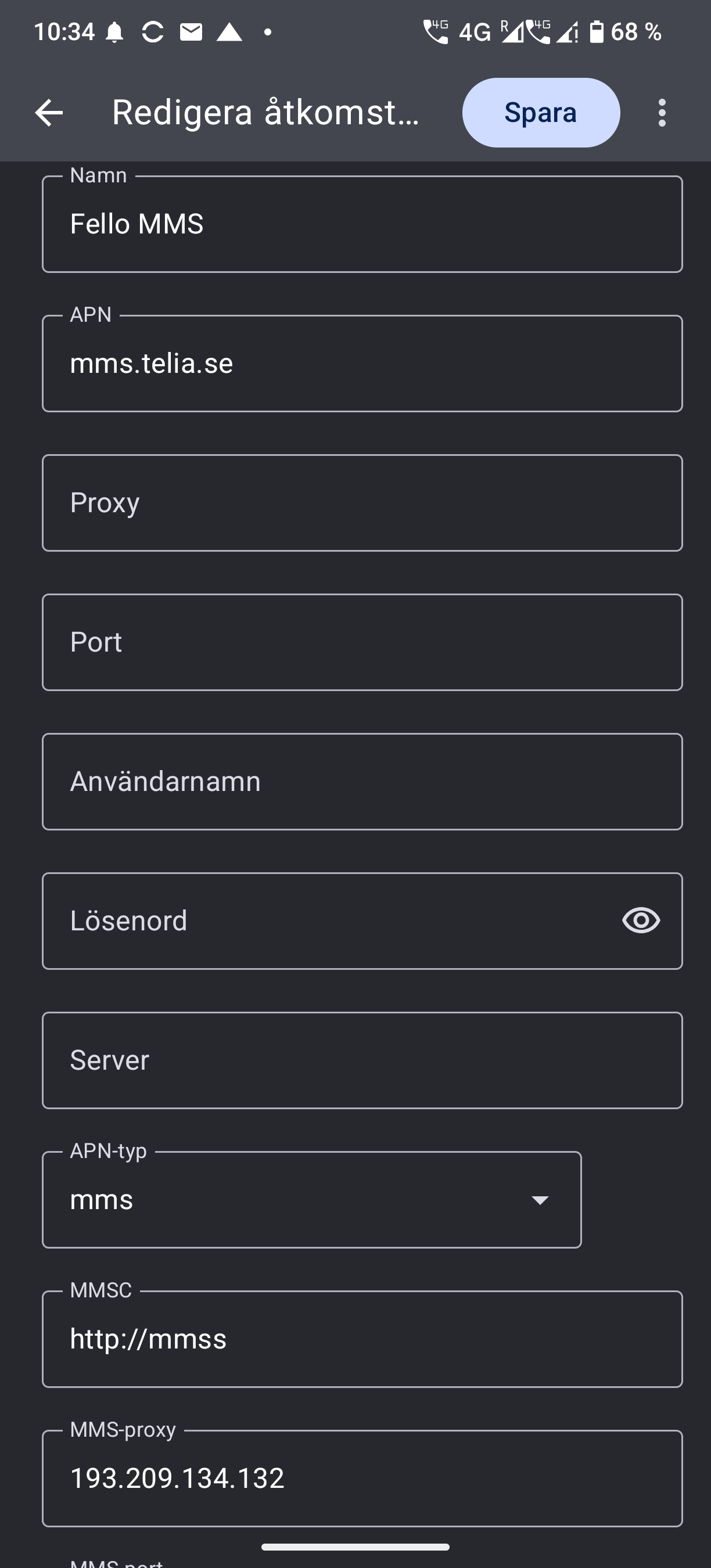

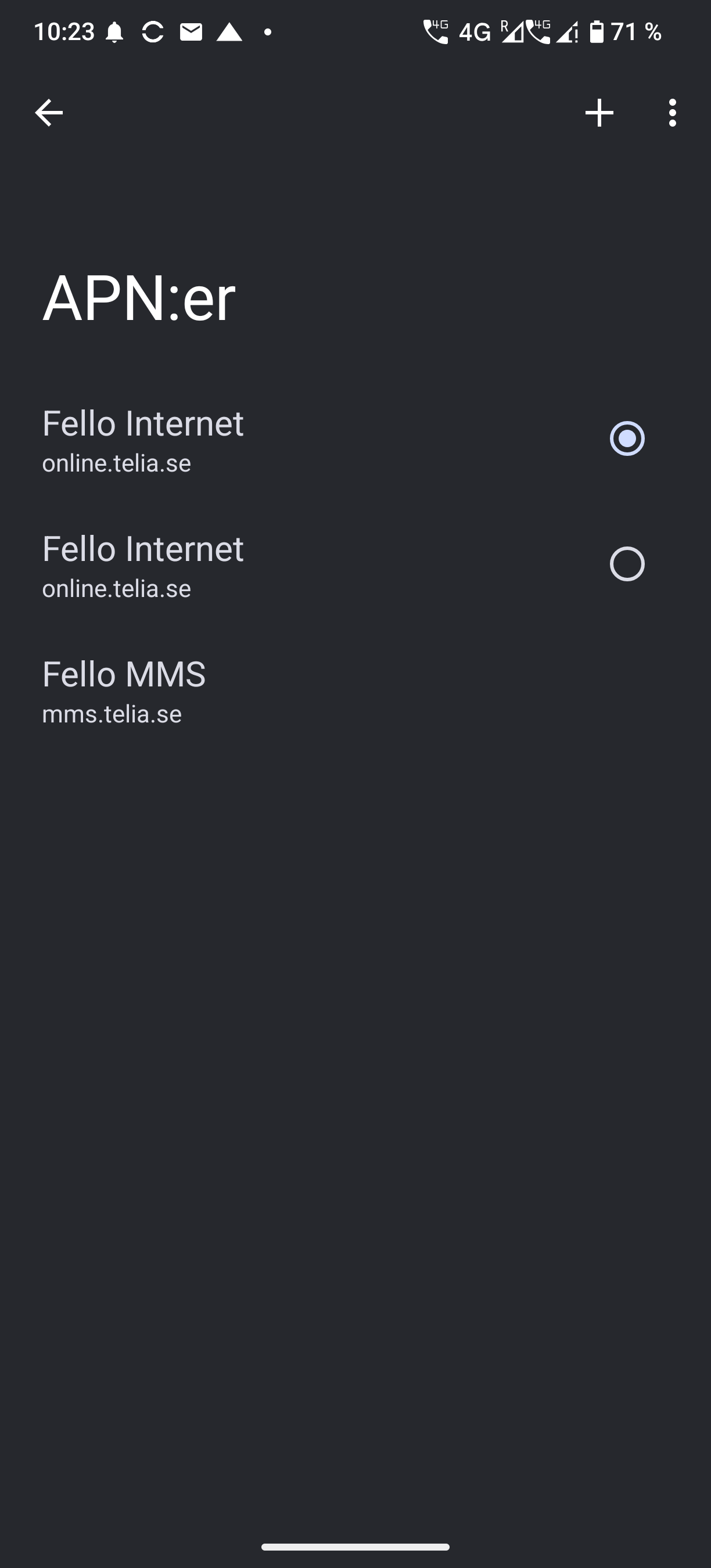

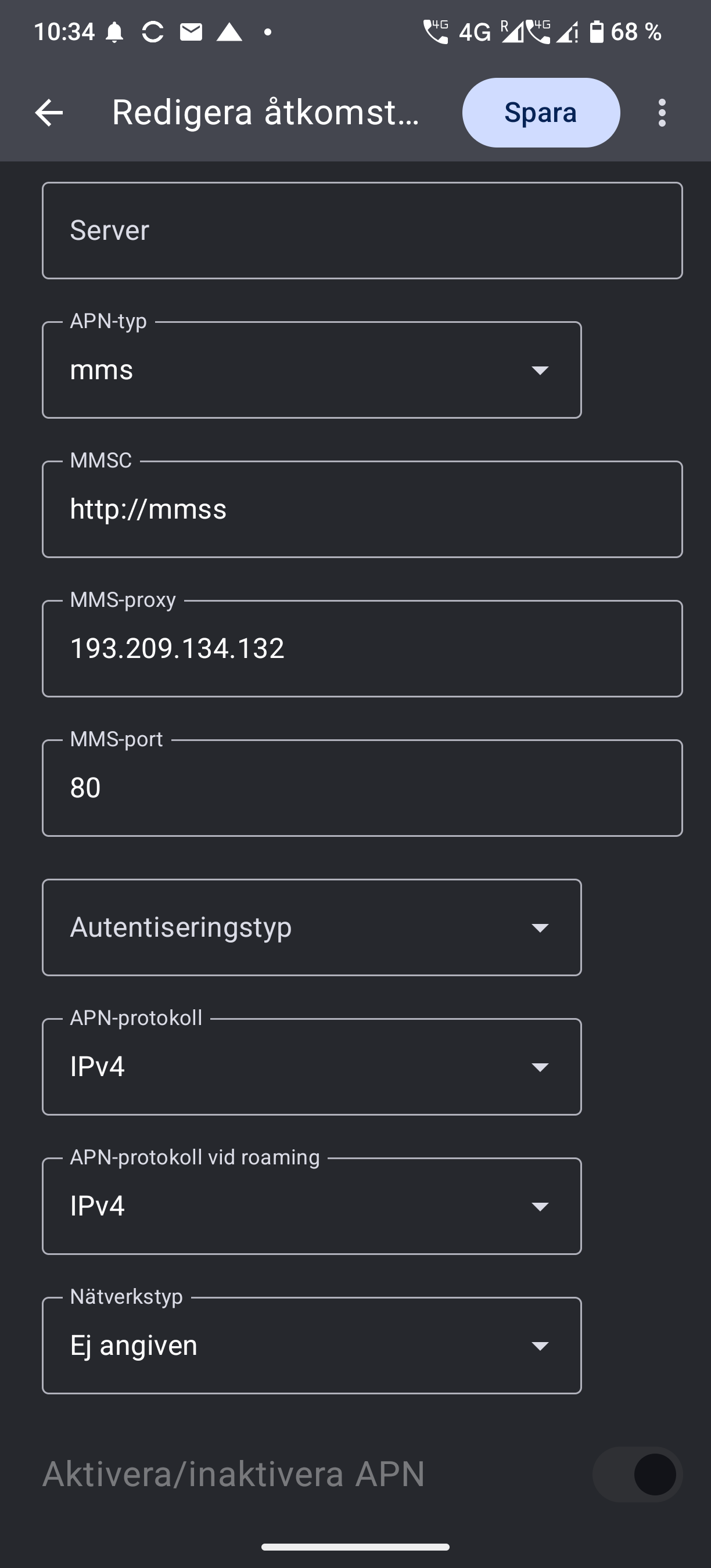

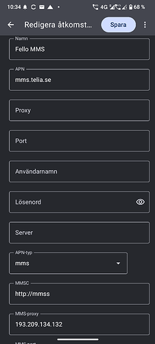

At Telia in Sweden, I had to set up a separate APN for MMS on the Fairphone 5. Manually. Only then did MMS work.
Since it is also Telia, the settings may be similar. If it helps for orientation, here is the data from the Swedish Telia.
Thank you Miko for sharing. I’ll try to compare the values with the one from Danish Telia and try to set it up.

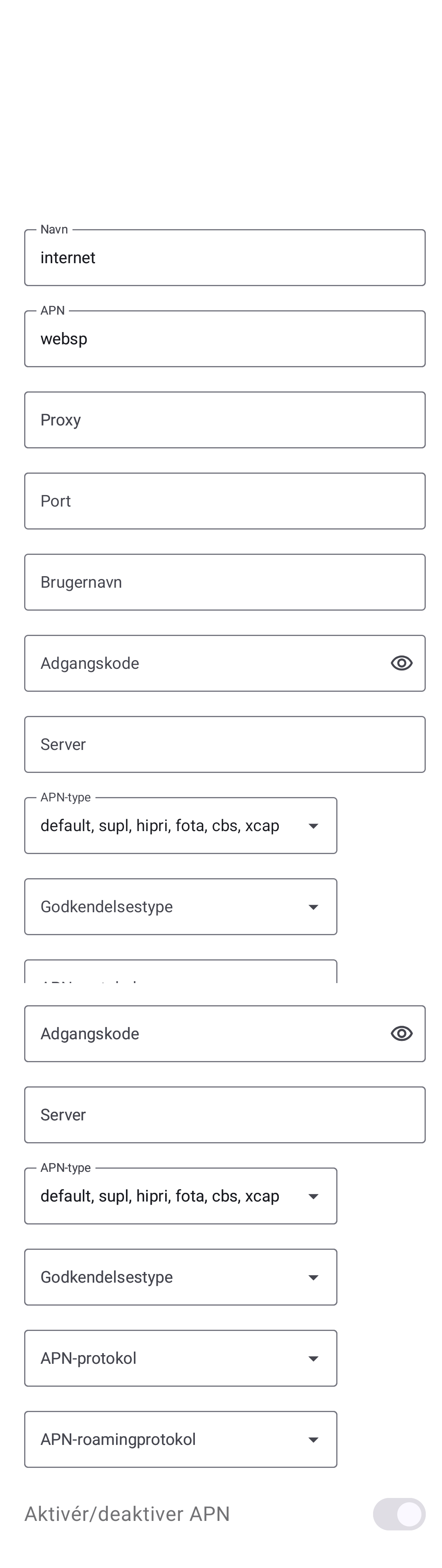

After many failed attempts. The Telia network provider in DK, helped me fix the problem. I had to change the mobile data APNs field ‘apn’ to websp and remove mms from APN type. Then choose ipv4/ipv6 i protokol. Then it worked.
I’m sure I tried that before, without help. But now it works, and I’m happy. Telia must have fixed it somehow.
Dear Rasmus -I have the same problem! Could you share the exact information? Eg a screen shot? Tnx
