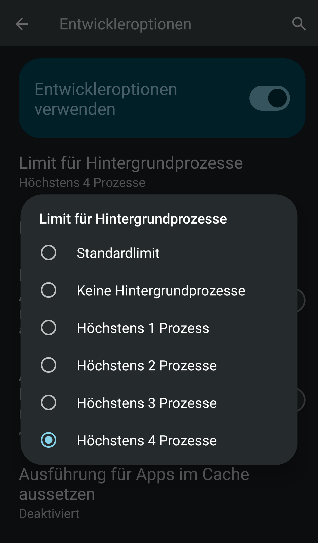

I changed these two settings in the Developer Options and so far it seems to help a bit!
Background process limit to maximum (unfortunately, the maximum is only 4)
Stop execution for apps in cache: deactivated
See screenshots (German menu)

Thanks for this info. I hadn’t in the past ten years had a reason to activate the developer options, but now I do : )
I made the two settings you described; after 36 hours I have to report they don’t seem to have had any effect on the problem – apps are still dying when i switch away and back, and get killed randomly when they’re running in the background (x-plore, antenna pod)
Memory use reports 3GB free on average over several days
I don’t know if this is an upstream issue or caused by something the Fairphone devs customized, but I hope they can have a close look – for me these issues clearly started with the update to A15

Unfortunately, for me these settings also had no positive effect in the long run
I really hate Google for that bad performance management in Android, especially regarding apps in background being killed way too soon.
And yes, hopefully Fairphone Devs will have a close look on this issue, that at least worsened massively with the Android 15 update for FP5.
