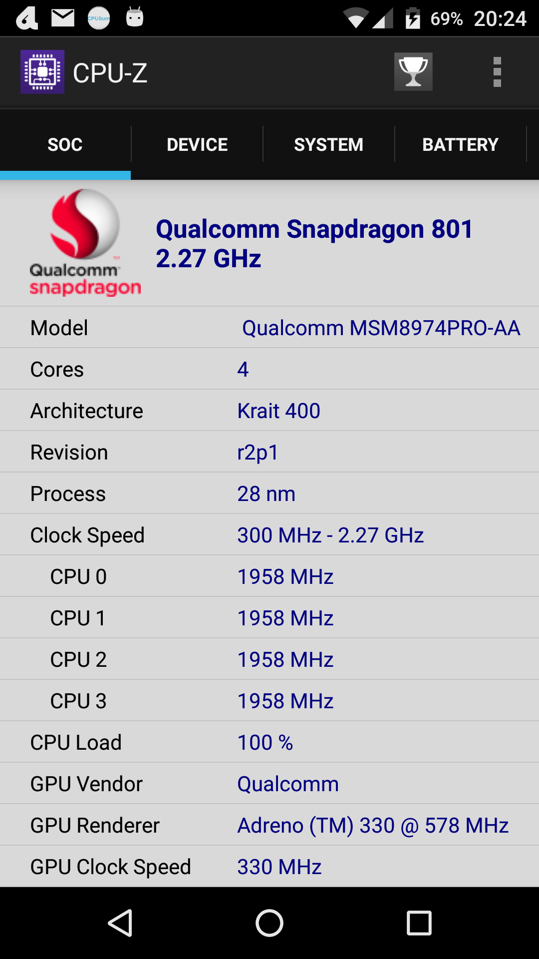

Could reproduce this rebooting misbehavior easily with a CPU burn test:
Fairphone 2 with FP Open, latest version, rooted and Xposed.
When set to 4G and running a CPU burn software (CPUBurn) at 99% stress, 4 threads, peak core temperatures (about 90 Celsius), I get consistent reboots about every 30 minutes.
When set to 3G and running the same stress routine, with exactly the same peak temperatures, I don’t get reboots.
In reality reboots still happen in 3G, although much less frequently than in 4G in my case. Yesterday night for example it happened when I tried to turn on the hotspot function at the end of a recharge cycle. Reboots are clearly related to elevated temperatures in the region around the radio chip. This is why it happens more commonly at the end of a battery recharge cycle or when using data or CPU intensively.
I’ll try to deactivate and reactivate radio when I feel that temperatures rise due to Internet use, I wonder if something in the radio system gets stuck in a loop causing overheating. Hope it’s a software and not a hardware design problem, since this is a wonderful phone otherwise.
To be fair, my previous phone, an HTC One X, used to have frequent reboots until they sorted out the bugs, it took them more than a year to stabilize the system, and it would still reboot sometimes when overheated or under cpu stress. But the Fairphone at this point is less reliable than the HTC was with their last system update.
