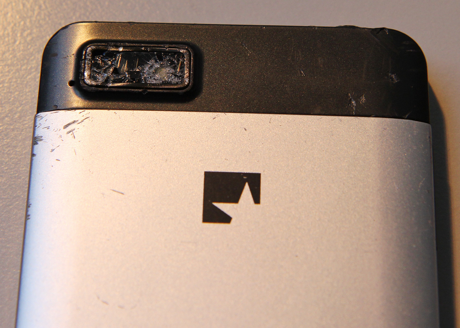

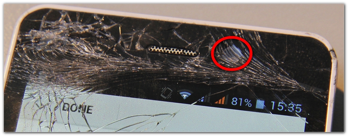

Hello,
these are the results after running my FP1 down by a car …
But to my suprise it’s still functional (after loading the battery which would be another problem – similar to Battery problems (wrong charging status / battery might be dying)). – Oh, except of the camera app (and the gallery app, too)! And also another “external” camera app do not work! After starting the camera – or here the gallery app – they crash:
So maybe I have to replace not only the front coverage/glass and the camera glass, but also the camera itself – or is there any chance to “resque”/re-enable the camera?

… some larger, more detailed photos of my damaged FP1 – “inside” only the apps using the camera, e.g. Gallery, do not work, they crash after some seconds, interactions are not possible (e.g. taking a “black” picture).
Any chance to get my Fairphone work “as before”? Or is it something for “tinkerers”? :wink:
The camera glass is part of the midframe which is a quite affordable spare part. The main camera itself costs a bit more, but the front glass can only be replaced together with the display which costs 70 Euros. See http://shop.fairphone.com/spareparts.html (detailed repair instructions right next to individual spare parts). Maybe you could perform the cheaper repairs (midframe, main camera) first to see if your FP1 returns to full functionality before you decide whether to go for the display replacement as well.

as described here the http://shop.fairphone.com/midframe-1.html of my FP1 was completely damaged
But all apps seeme to work – except for the apps which uses the (rear) camera module, e.g. the app “Camera” :wink: of Android.
Few seconds after starting the app it crashes (and there appears no picture, too – only a blank screen with the touch symbols of Camera).
Therefore not only the midframe is damaged, but the rear camera (http://shop.fairphone.com/spareparts/fp1-spareparts/rearcamera.html), too?

And last question: how can I check if the front camera still works? And if not, is there a replacement for it as for the rear camera? I can’t discover it on http://shop.fairphone.com/spareparts/fp1-spareparts.html
Thank you again! webaschtl
Try testing mode. It has camera test options; there may be useful hints about what to expect in the test in this topic.
I think the front camera is soldered onto the motherboard, and is therefore not available as a separate component.

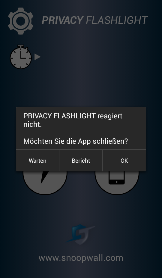

just installed this app:
https://play.google.com/store/apps/details?id=com.snoopwall.flashlight&hl=de (do not need any further permissions)
But this app crashes, too (as Camera app of Android or the Gallery), just after trying to start the flash :frowning:
Now it’s the question if only the camera module is damaged or only the flash light (both need each other?) – or both…
Hopefully the FP support know the answer :smile:

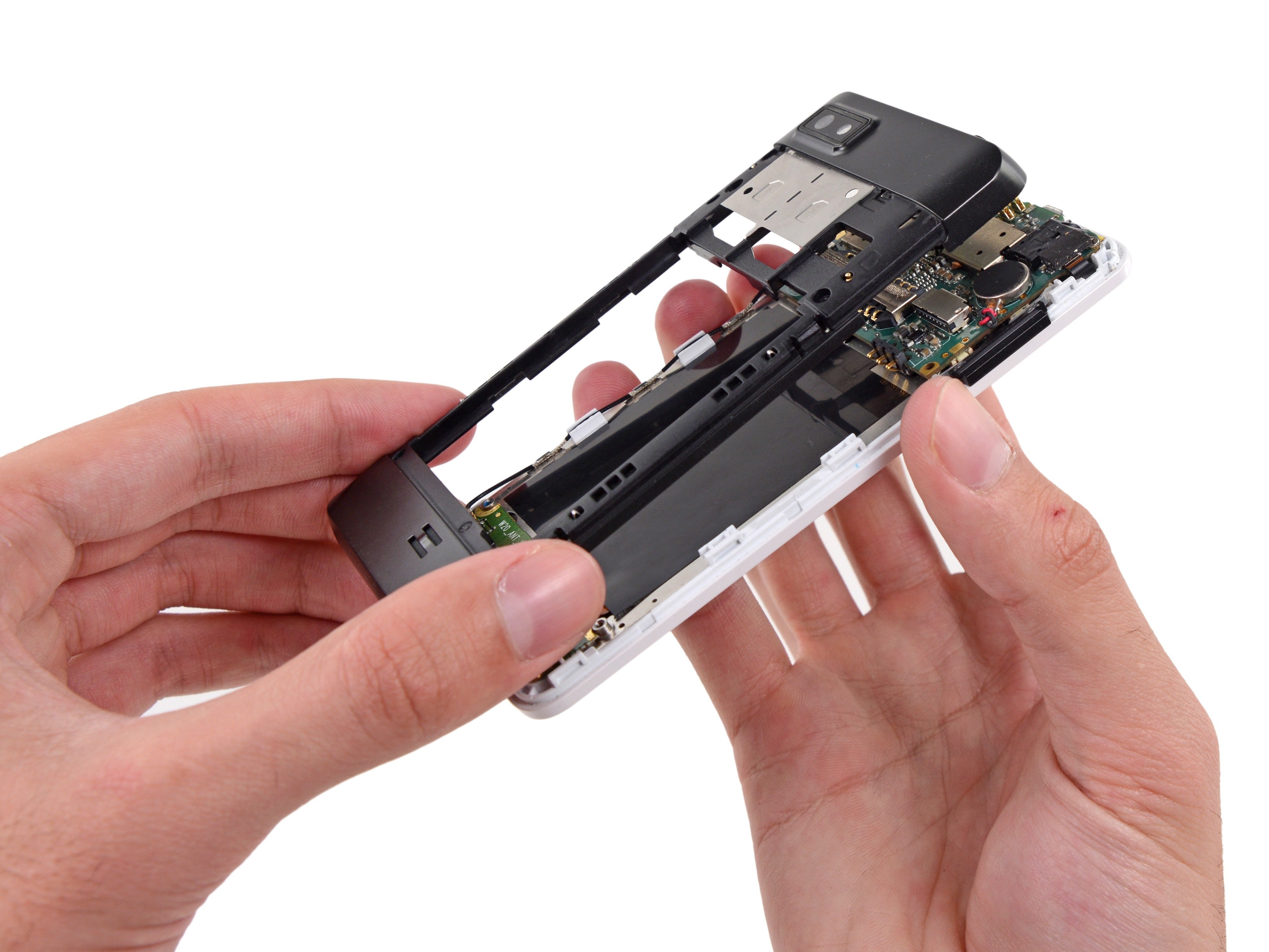

Replace the Rear Facing camera in your Fairphone.
Replace the Midframe in your Fairphone.
