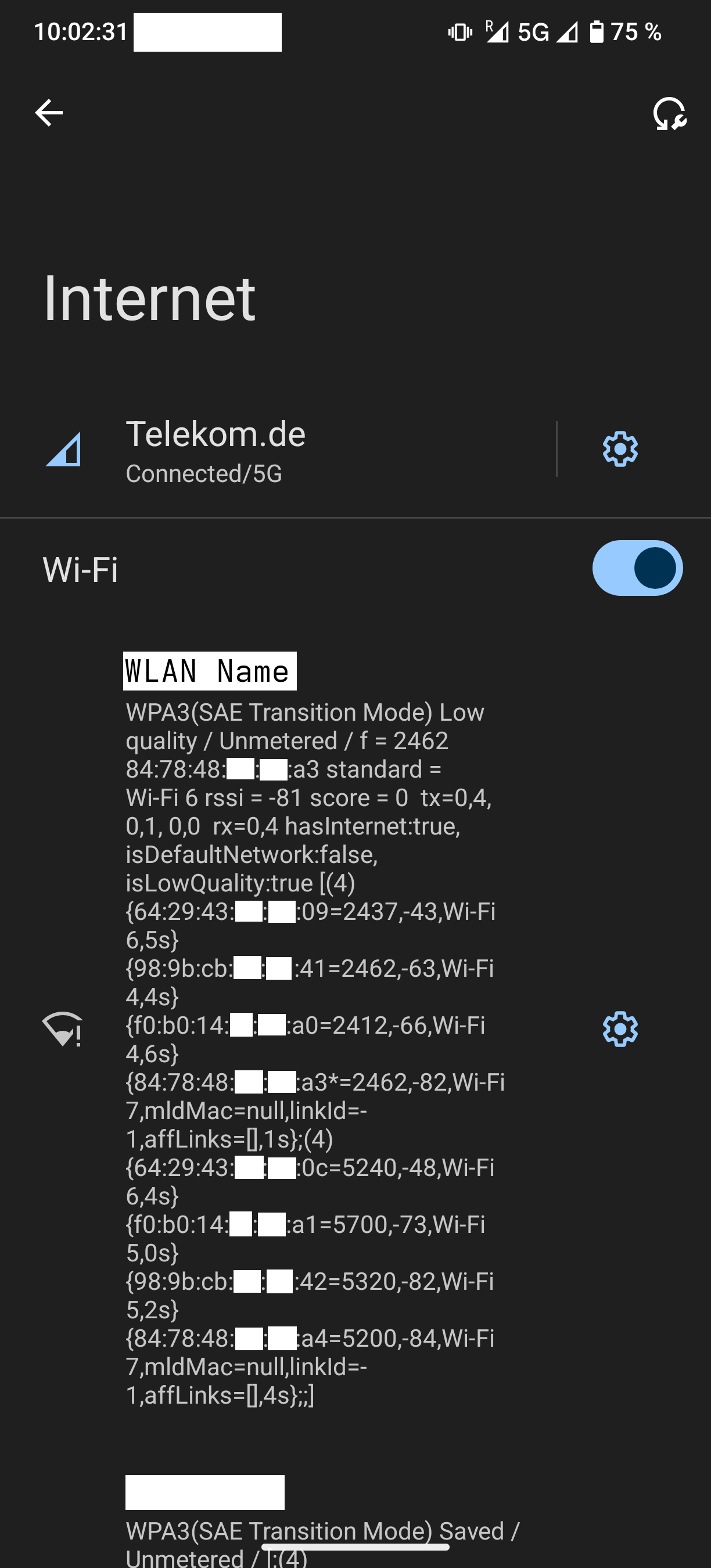

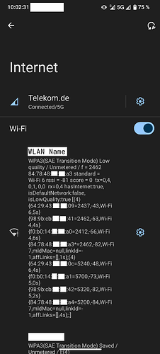

Screenshot of Settings > Network and Internet > Internet durring an occurence of the Issue:
Several extracts from WifiScoreReport from adb shell dumpsys wifi:

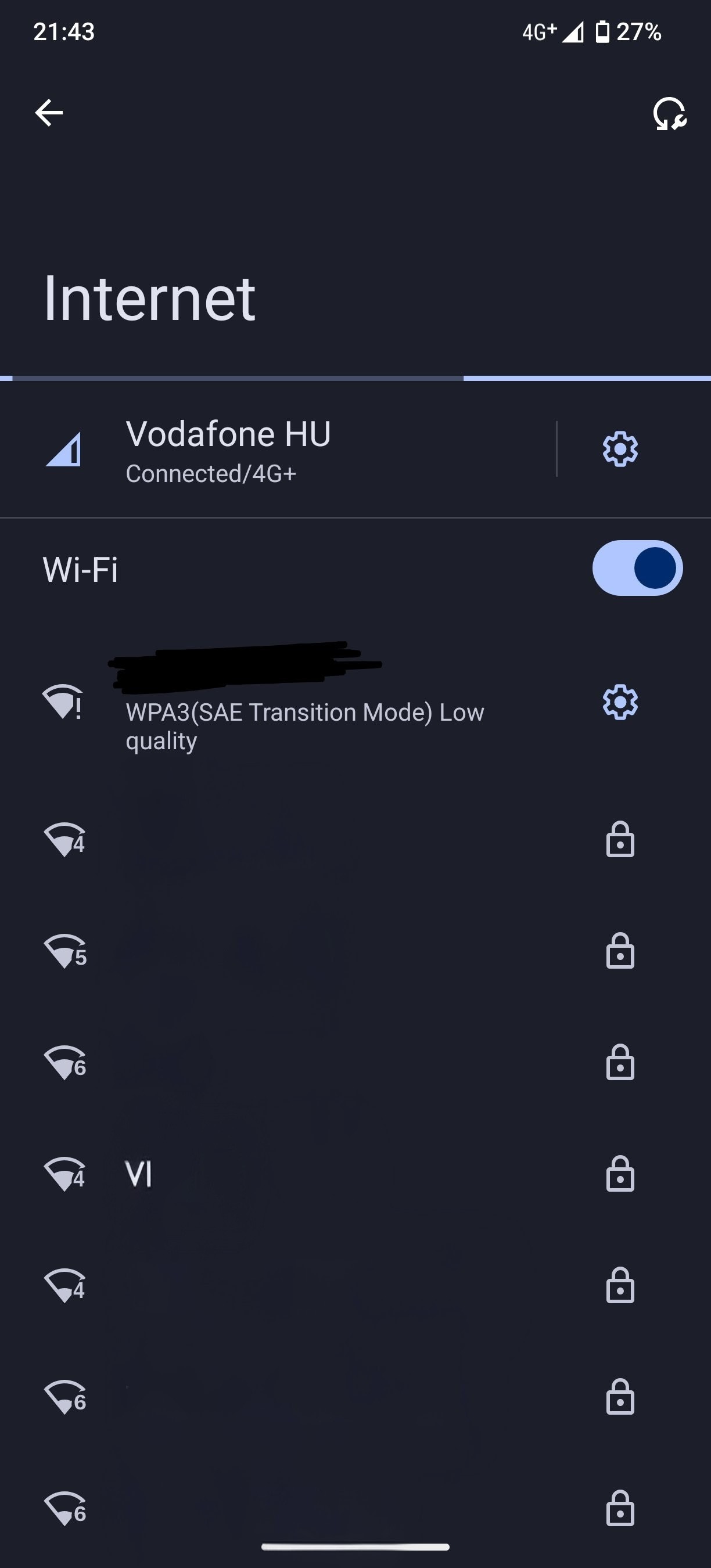

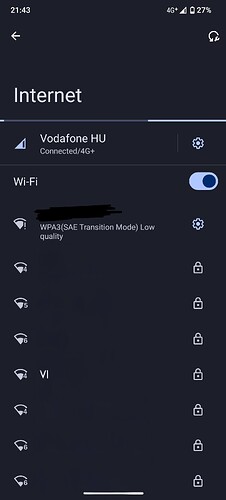

A new behavior that has reared it’s head in the past ~3 months, is being connected to wifi, yet the phone uses mobile data. When you go to wifi settings, you find this message.
Low quality wifi. I can assure everyone, the signal strength icon is accurate, and the signal is very much not weak. In fact, the screenshot was taken while I was about 1.5 meters away, in line of sight, to the router. If mobile data gets disabled, the phone resumes to using wifi, but the low quality message stays for about a minute longer, before it realises all is good.
