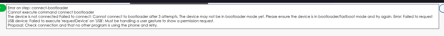

I am stuck trying to install e/Os on my fairphone 6 running android 16. I’ve used the webinstaller succesfully until I reach step 9, then I get this message:
When running adb and the fastboot command ¨flashing unlock” in the terminal, I get the message ¨waiting for any device” and am unable to go further.

Most likely you need to install bootloader driver when you use a windows PC
Hello @Ullie, Welcome to the Fairphone users forum.
Thank you for your answer, but I am not on a windows pc, but on a linux (zorin 18) pc.
is the device in Bootloader mode ?
do you use a real Data capable USB cable ?
Yes, it is in bootloader mode and I am using a data cable.
like recommended in this guide :
Thank you for all the help! I’m so happy people are here to contribute ideas. Next weekend, I will try to follow the steps of the safe guide you send. I’ll let you know if it worked out!
Have a nice evening!
Thank you. I have managed to install e/OS now with this guide. I was hesitant to try this at first, because it felt a bit intimidating to me. Apparently the trick is not to start using online installer and when it gets stuck, switch to using the terminal with adb and fastboot.
