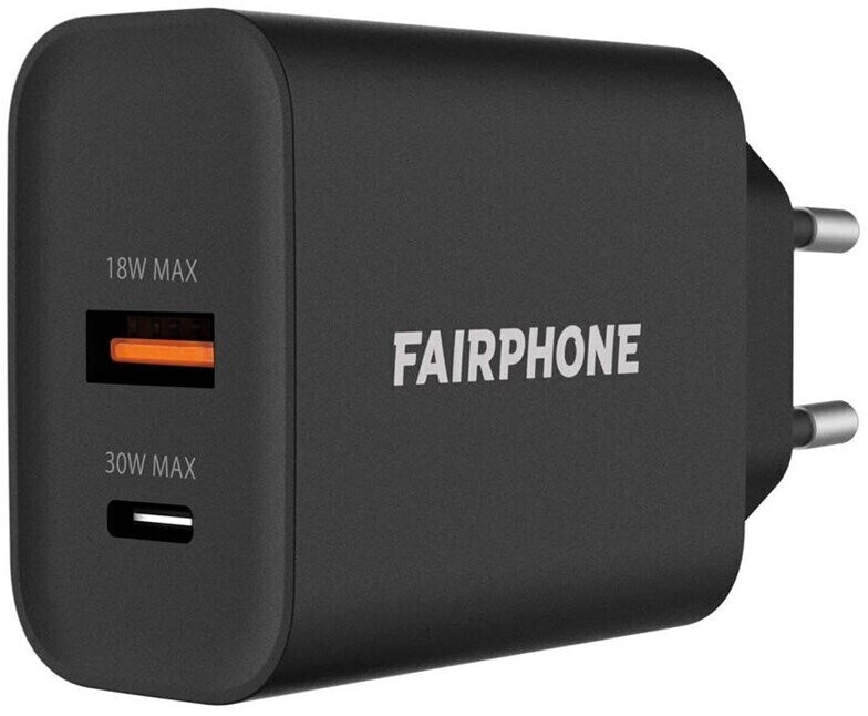

Hello, I just faced the same issue, I tried the same things an got the same results. I’m currently trying to get my fp6 repaired but Murena (the provider) took to much time just to simply send me a shipping label, I’m very disapointed and angry at this point, this may be the most reparable phone but if if have no clue on how diagnose such a problem we can’t do anything
Did you use fast charging when/before that happened?
Yes I’ve been using this one with the 30 W Max port :
And you enabled fast charging in the settings? Anyways this should definitely not be happening but fast charging may be too much for the FP6. Note that another also had his FP6 dying although he enabled slow charging so it may still be unrelated to charging speed.
