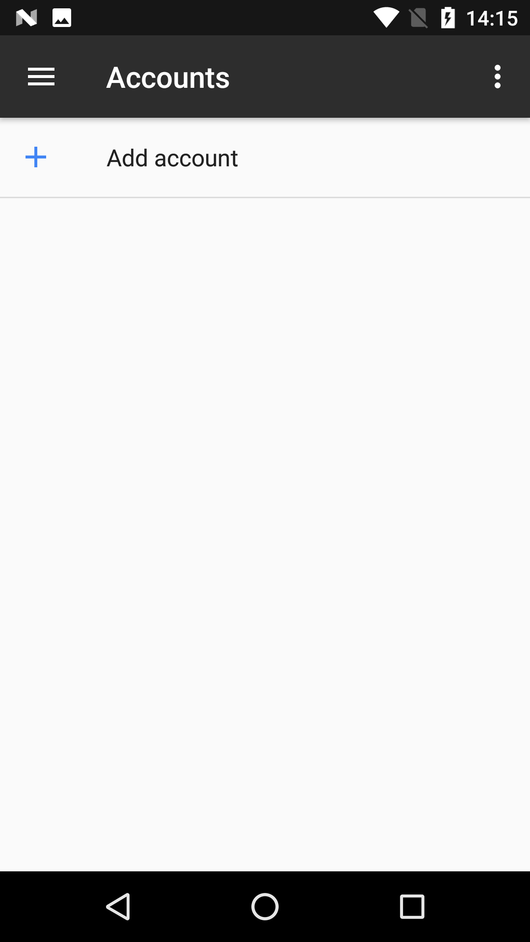

This is what Settings > Users looks like on the FP2 (Fairphone Open OS 19.08.1):
I guess the separate “Accounts” settings aren’t relevant in this context, but for completeness’ sake:
Tapping guest where it’s shown in the image should start a guest session. On my test phone it takes a while to start (and at first it seems nothing is happening). Switching back is a case of going to the same menu and choosing ‘remove guest’.
