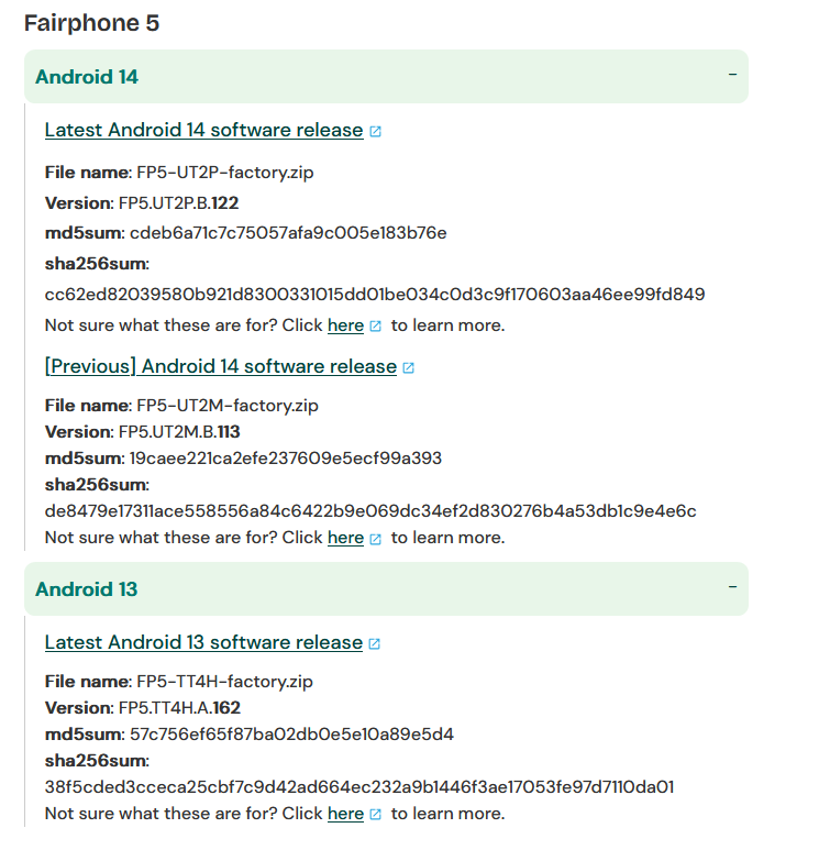

Which version should I choose to be sure not to brick my device (not sure of the term, but I read that it’s an important thing to consider ^^)?
Thanks for your answers and advice!
Definitely go for the first listed Android 14 release (ending on 122) in your screenshot, it has a :white_check_mark: more recent security patch level than the one you are currently on, see https://support.fairphone.com/hc/en-us/articles/18682800465169-Fairphone-5-Release-Notes
Thank you for your reply. I’ll make a note of that. This version does indeed have the same security update level as my current E/OS.

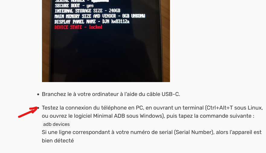

I got stuck at the step where, after putting the phone in Fastboot mode, plugging in the device (a little sound from the PC indicates that the phone is recognized), and testing the connection via the terminal by typing “adb devices,” it couldn’t find my phone.
However, it found it by typing the same thing when the phone was in the classic interface. It only doesn’t recognize it in Fastboot mode…

Because you need to type in fastboot devices in fastboot…
Normal mode is for adb and fastboot/bootloader mode (your screenshot) is for fastboot
And to be clear when this does not work you must search for bootloader driver manually when the FP is connectwd in this mode to your computer, I dont think standard USB driver include those.

I followed the steps carefully. Is the tutorial in my link incorrect?
Yes, it is incorrect.
Your phone is in fastboot mode at this point.
You need to use the fastboot command then, not the adb command.
Fastboot mode (also known as bootloader) and ADB (Android Debug Bridge) are two different things, so the fastboot command and the adb command do different things in different states of the phone.
Notice how the next commands in the tutorial you linked to start with fastboot, not with adb.
Likewise, on Windows for ADB and fastboot you will need different drivers. The USB driver you linked to will most probably not help you with fastboot mode, it’s most probably an ADB only driver, because the Android Studio context in which it is given doesn’t need anything else.

When I typed Fastboot device in the terminal, in fastboot mode, I got my phone’s S/N. So, in fact, everything was fine. I just got stuck because the guide said to type “adb devices” and it didn’t find anything.

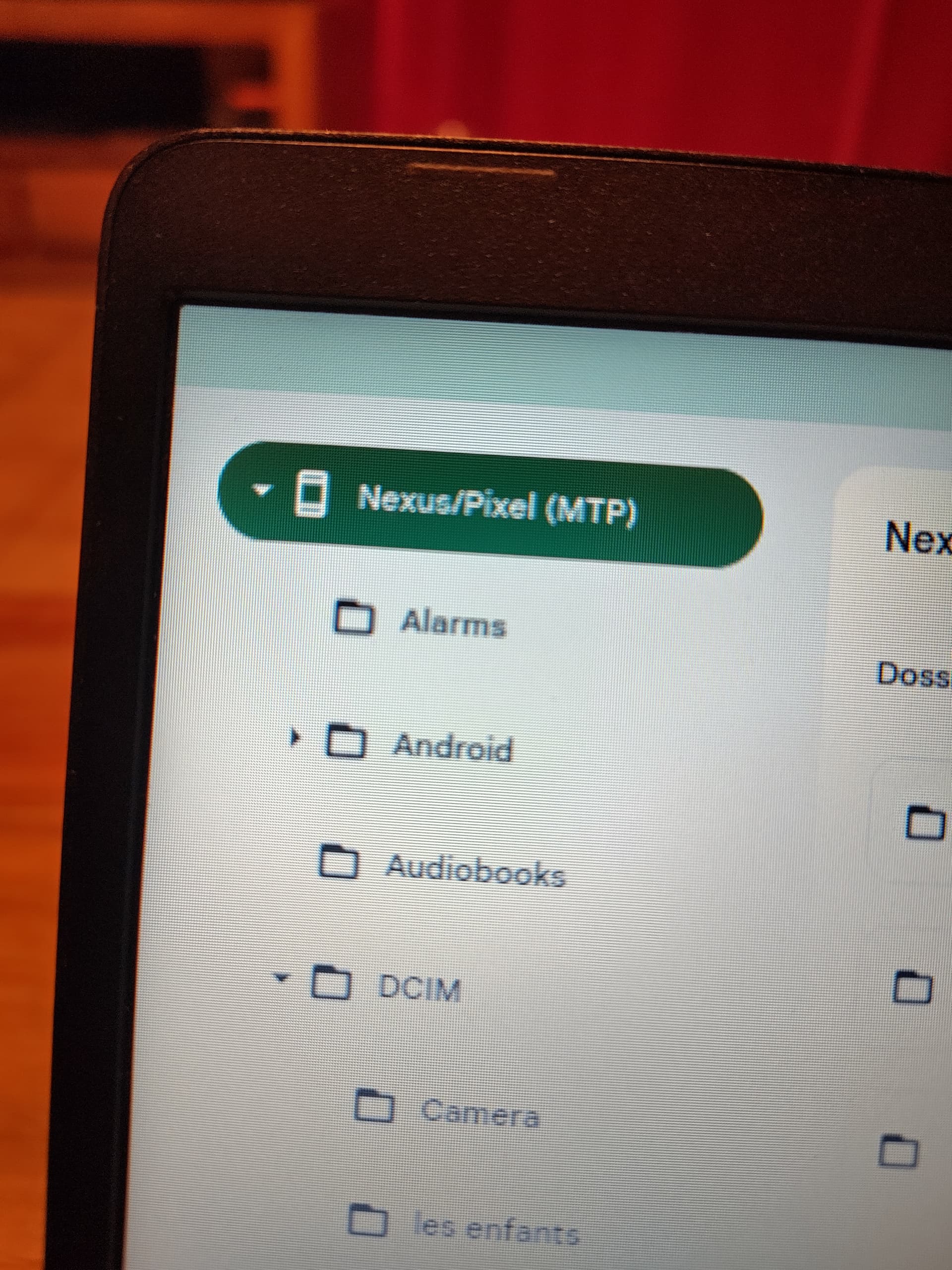

Quick additional question: after finally switching back from e/os to Fairphone Os, I connected my phone FP5 to the computer. And the device name that appears is strange:
Do you know why and how to restore things? Is it related to the e/os option that masked and imitated another device to avoid detection?
There is such an option?
Anyway, it could as well be the driver used by Windows deciding on an odd name.
The important thing is that the connection works. MTP is not very device-specific, it’s a general and universal method of file transfer.

Last night, I noticed this strange name when I connected my FP5 to my Chromebook.
But this morning, when I connected my device to my work Windows PC, I did see the normal name “Fairphone 5 5G.” Everything seems to be back to normal :slight_smile:
