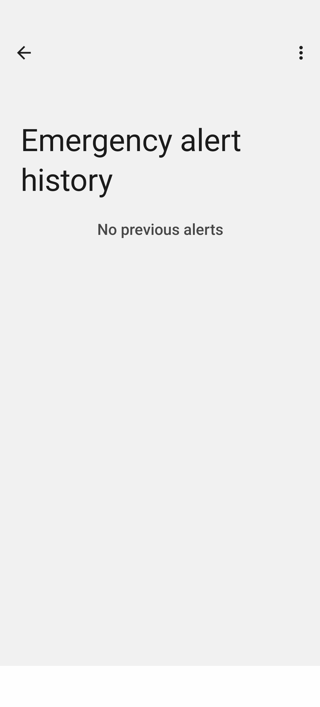

I did not receive the 15:00 UK Emergency Alert System broadcast
Diagnosis
I’ve confirmed I haven’t:
  1. #!/system/bin/sh
    cmd activity start --user 0 -a android.intent.action.VIEW -n com.google.android.cellbroadcastreceiver/com.android.cellbroadcastreceiver.CellBroadcastListActivity -f 0 com.google.android.cellbroadcastreceiver
The undermentioned returned nothing:
#!/system/bin/sh
dumpsys notification --noredact | grep 'This is a test'

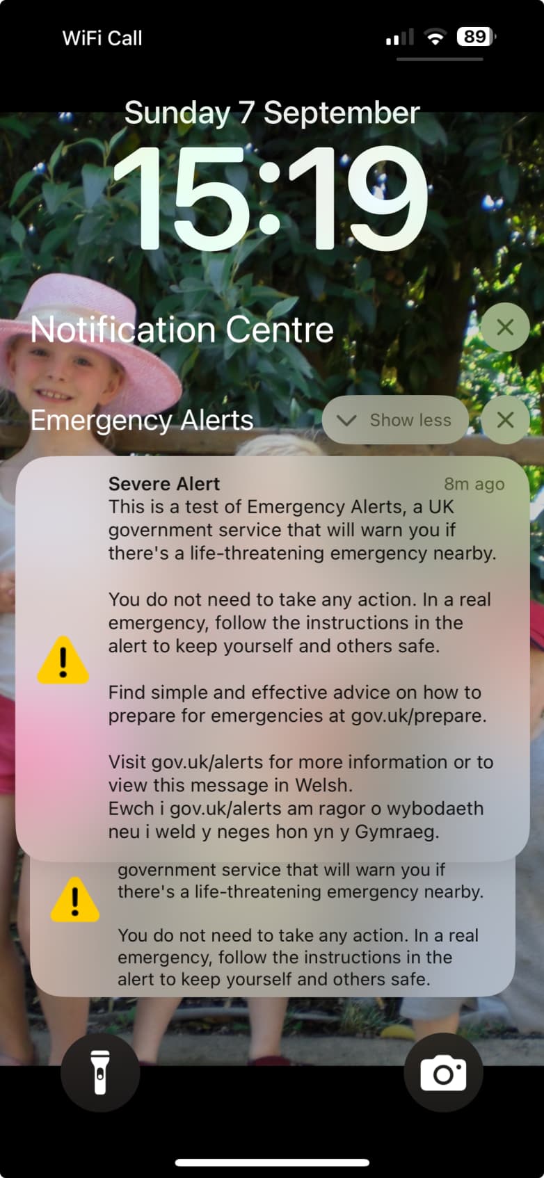

I’m using Hutchison 3G UK Limited’s “SMARTY” carrier. However, as is my mother, who did receive the alert:
Has anyone else? If so, I’ll contact my carrier.
Context
For context what type of phone is your mother using? Last time this was tested in UK this carrier had some issues which presumably have been addressed.

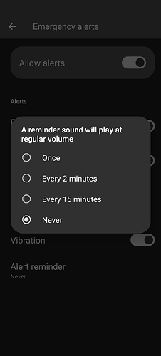

Wondering how its sent/working I think to make it work here in germany a setting had to be enabled? So did you allow emergency notifications?
@yvmuell, it can be disabled, but it wasn’t:
  1. #!/system/bin/sh
    cmd activity start --user 0 -a android.intent.action.VIEW -n com.google.android.cellbroadcastreceiver/com.android.cellbroadcastreceiver.CellBroadcastSettings -f 0 com.google.android.cellbroadcastreceiver
Thanks to /4, I can be confident that the device and (and, likely, AOSP distribution) support it (since if /e/OS does, FPOS shall). In that case, because gov.uk/government/news/emergency-alert-test-frequently-asked-questions states:

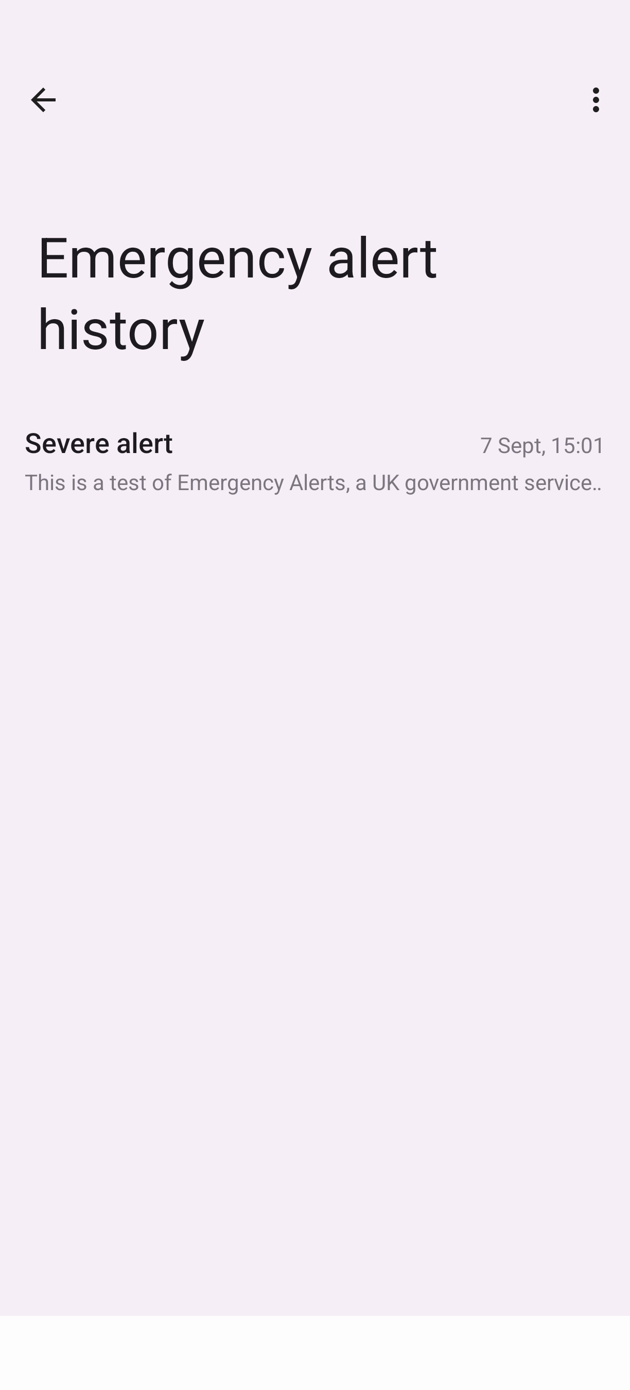

I can confirm I received today’s alert. I’m with ID mobile

I notice a difference between your settings and mine: under Alert reminder I have the value “Once”, you have the value “Never”. I received the alert (FP4/ FPOS/ MVNO spusu/ Carrier EE). What does your mum have under Alert reminder?
Tap on Alert reminder to change the value.

@JulianR, I’d be mighty confused if that preference somehow determined this:
