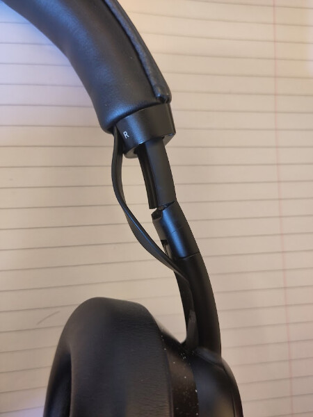

Mine snapped again today (already replaced October 2024).
They live on my desk, go on and off my head gently (but pulling open enough to go over my ears). It’s not as if I’m stretching them out particularly wide or twisting them.
The break is in the exact same place as last time, and there is clearly more strain going onto these brackets than the plastic can handle, either because of the particular mix, or because the strain is just too focused to ever work with a pure-plastic part.
It’s worth noting that the lower half of the bracket below the hinge is metal, so clearly that side was expected to deal with stresses.

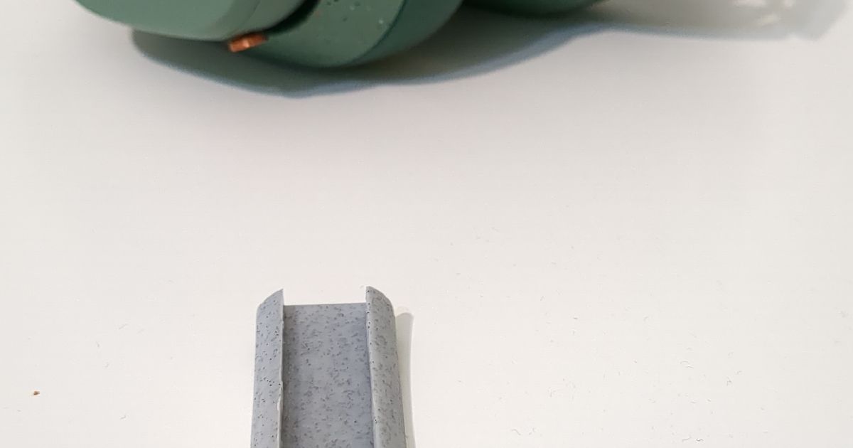

because @0nn0, @BerserkBamse and @djsf asked about 3d printable version of the plastic piece: After mine broke for the 2nd time I started to design the piece but user pavelb was faster and delivered this wonderful piece (i printed it and it works):
So before ordering the replacement piece: check if you only need the plastic part and maybe you have access to a 3d Printer or to a hackspace, fablab, open workshop in your area…
I love that somebody out there just fixed this problem for all of us! <3

It’s cool to see a 3D-print pattern for the weak part though! I was mistaken before, the plastic half is not moulded onto the metal-hinge.

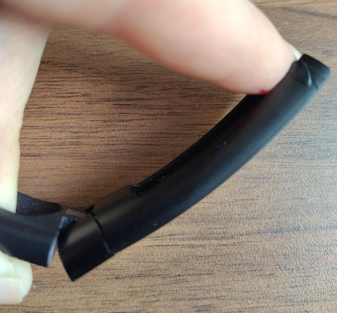

Just want to add my voice to this thread, got the green ones and they worked fine for about 9 months before the right headband base snapped. I then noticed some hairline fractures on the left side.
I ordered two replacement ones and fitted them fine, within a month the right one snapped again.

Thanks for this. Got a local 3d printing shop to do this for me (got a few spares as well just in case) and it fits perfectly. Now fingers crossed it’s made of stronger stuff than the original part.

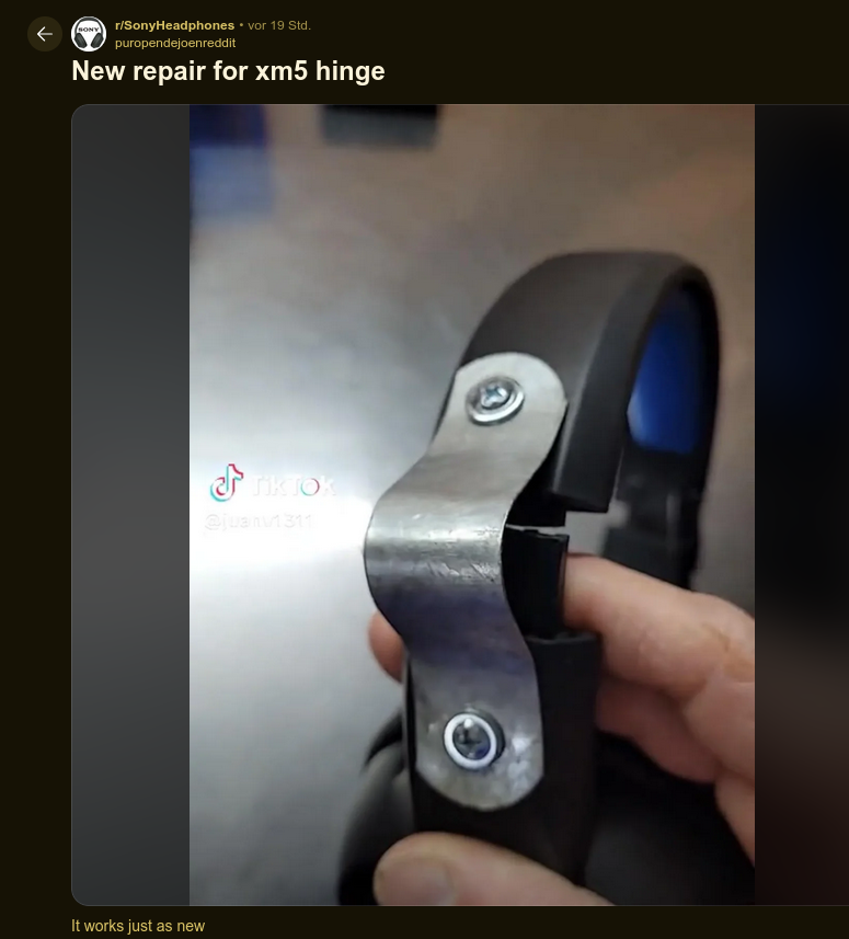

If someone needs some inspiration about how to fix a weak hinge :grimacing: :
link to Reddit
I’m glad you had some success - I will keep trying :slight_smile:
So according to reddit, you can use acetone to weld the pieces together.
In the long run, though, this is unacceptable. This so called “eco” brand is pure greenwashing with how it designs utter flimsy tat without bothering to iterate on the design because they think selling the replacement parts at a MARKUP is somehow “circular economics”.
I’m still repairing my fairbuds because I LIKE them, and because some folks pulled 3d models out of the aether to allow us to print our own replacements. Meanwhile this company is pretending they give two shits about any of the ethics or sustainability that is plastered on their website.
Nope, the plastic doesn’t melt in acetone. Sigh.
I’ve used a flame to heat a small carpet tack and melt it into the pieces to hold it together, and then used a 3d printer pen to reinforce the joint before finishing with tape. It looks terrible, but at least I can wait until my 3D printed part comes in the mail…

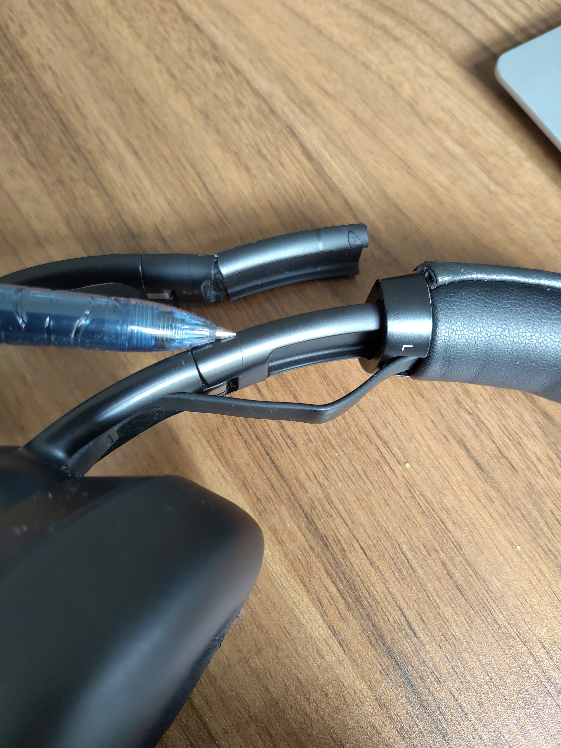

I think I found the root cause…
If you want to travel and you put your Fairbuds into the bag, you will close the headband base and it is ok… but when you want to open it the pressure that is applied when opening is too much…
