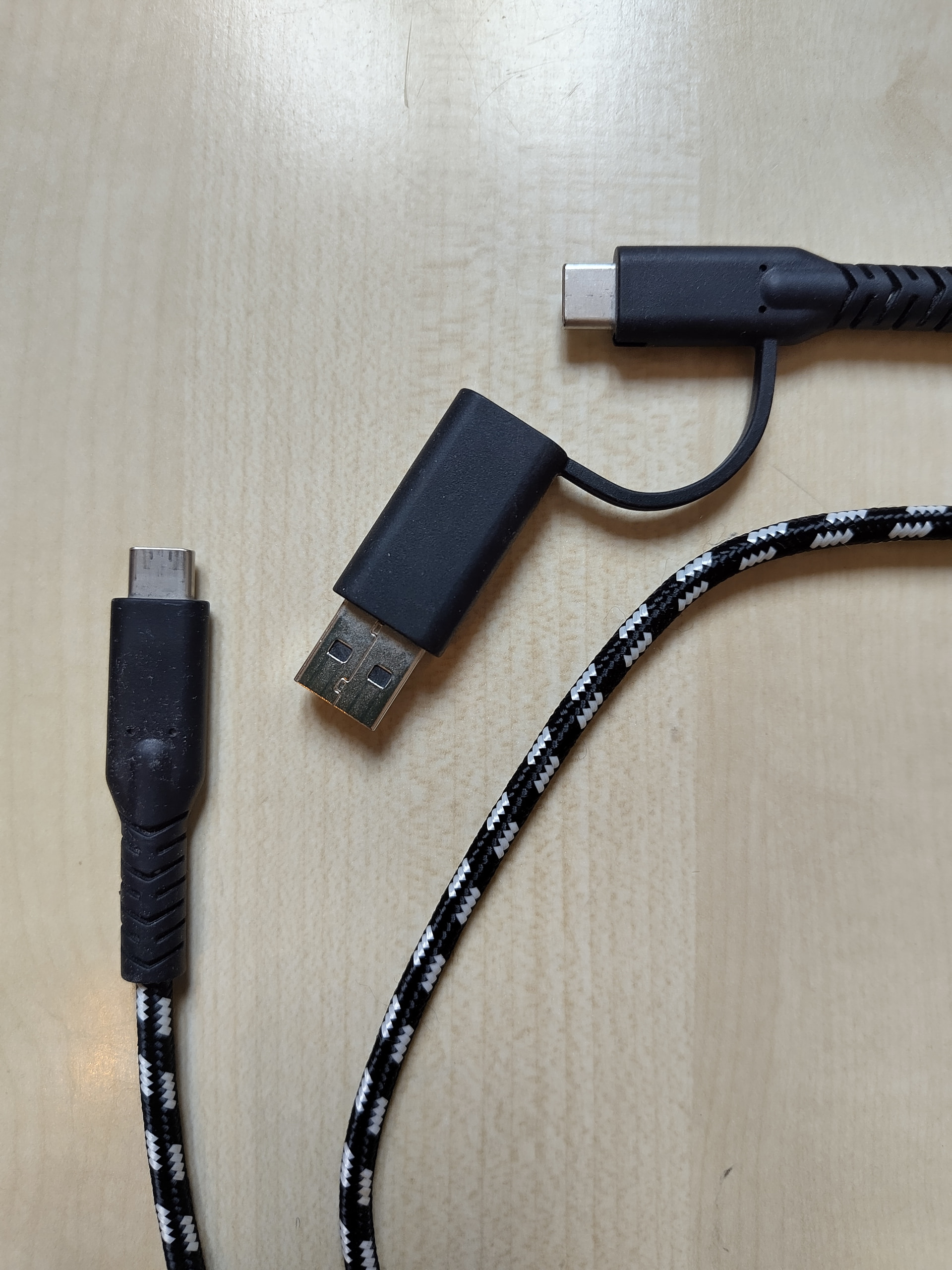

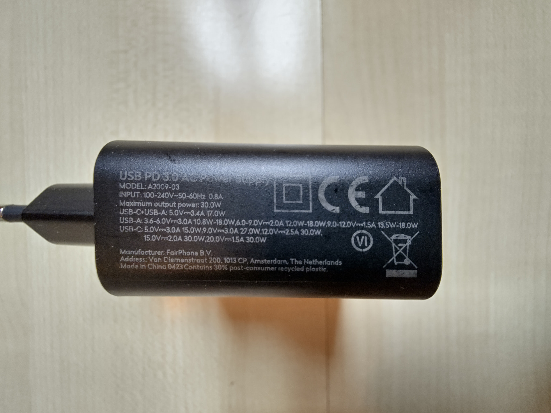

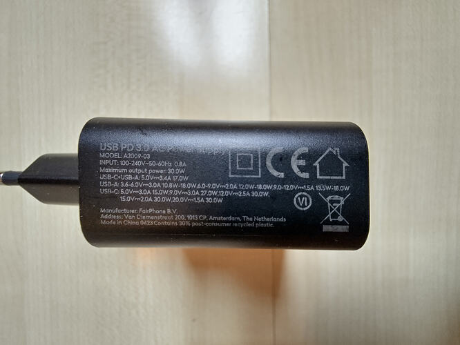

Also, besides different chargers, does this also happen with different cables? If it’s useful to know, I use the charger and cable in the pictures below (USB PD 3.0 AC Power Supply Model A2009-03).
I use the USB-C to USB-C connected to a “30W MAX” input on the charger.

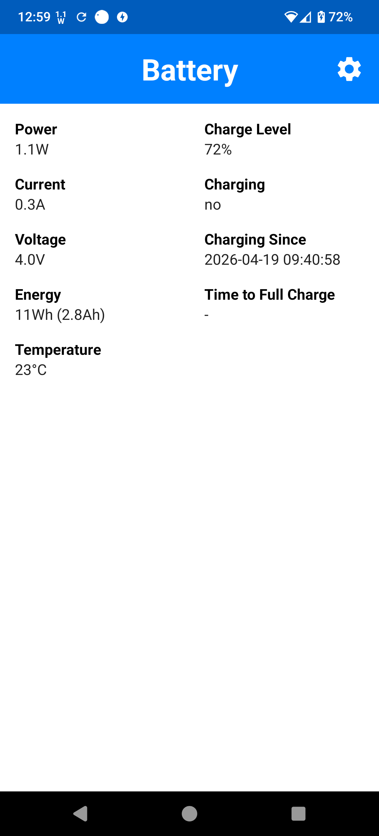

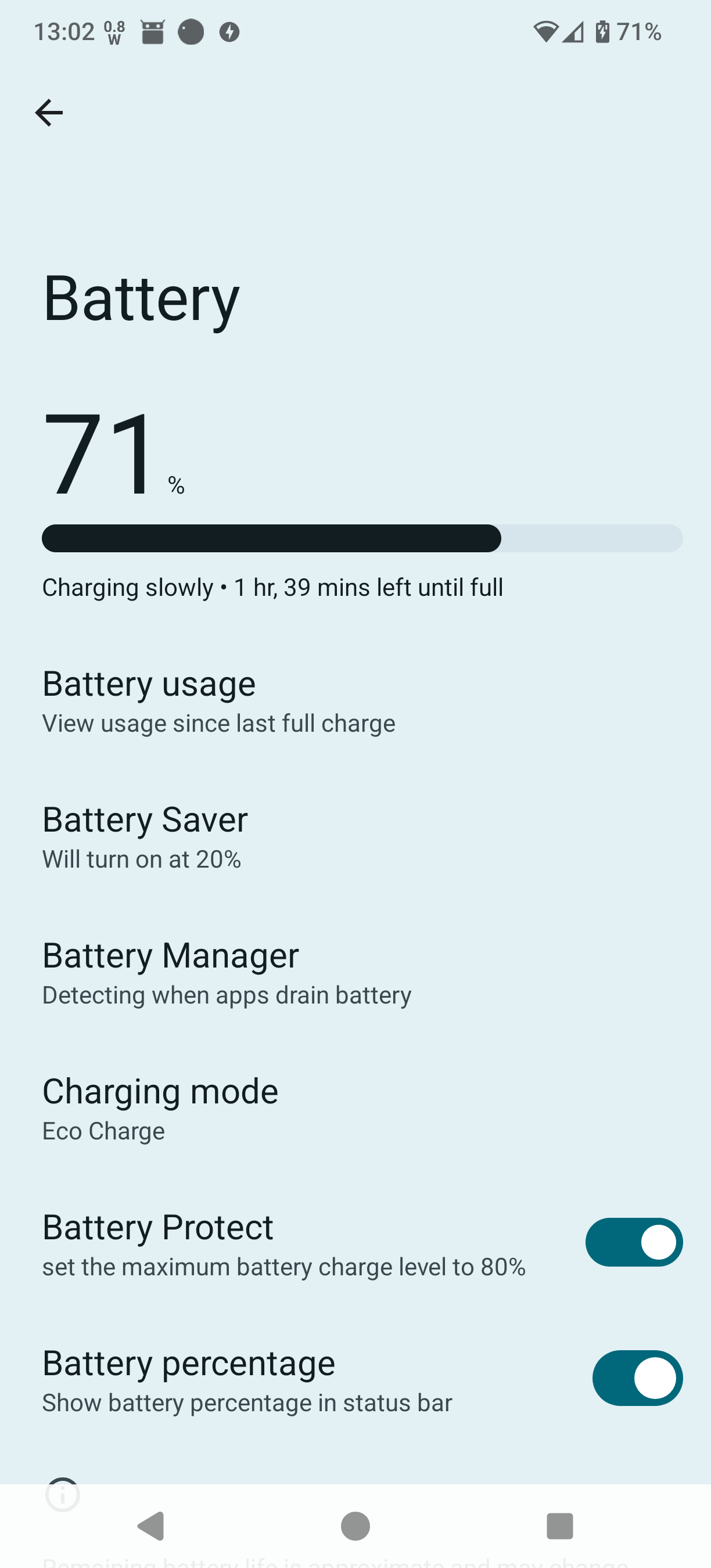

Now I ran in such a case, actually.
My phone is plugged in for a while, has charged from ~20% to ~75%. Then, it started to discharge. The power cord is still plugged in as before, and the charging indicator still on.
However, it is discharging, as Wattz correctly tells me.

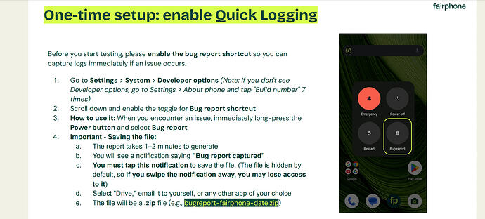

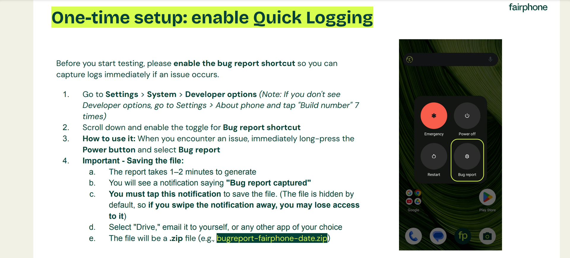

As for “other debugging/logging tool that could be handy”, the Fairphone beta testing guidebook describes a way to enable a Quick Logging shortcut for bug reporting (screenshot attached).
I think it’s worth it to capture a bug report the next time you see that the phone is not charging (as reported by the Wattz app) but the Battery settings shows, incorrectly, that it is charging.
