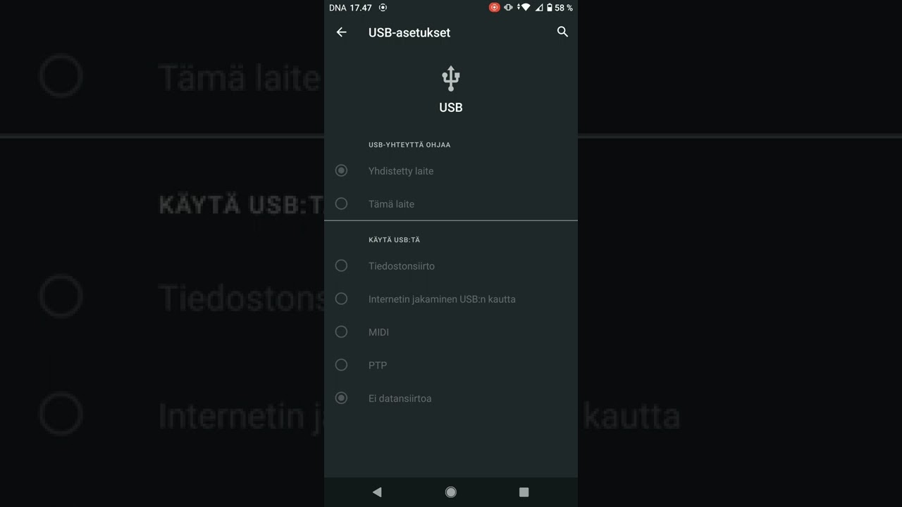

Yeah, I’m beginning to think there’s definitely something wrong with the module. Here’s a screen recording what is going on in USB-settings. It’s in Finnish but I think you get the idea.
Any ideas?
Looks like a connection problem to the screen, affecting just one part of the screen. Right at the end of the video you show a different text but the flickering occurs at the same place on the screen.
If the phone is still under guarantee then you could send it in for repair.
If it’s not, then I would recommend you to disassemble the phone (but don’t take the modules apart to begin with). Use compressed air to get rid of dust. Clean all contacts with cotton buds and isopropyl alcohol. Leave to dry for several hours before reassembling the phone. Be careful not to over-tighten the screws, or you may strip them.
You can follow the iFixit teardown (I don’t think you’ll need to go beyond step 7).
Thanks @OldRoutard. I think it´s got something to do with the connections of the USB-port, not the whole screen as flickering doesn´t happen anywhere else. It seems that the phone thinks another USB-device is connected or keeps getting contacted to it, although it´s not. So maybe some dirt of something in the usb-port makes it think there is another device.
