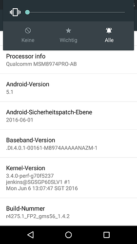

However, right now I am mixing the old baseband firmware version (.DI.4.0.1-00161-M8974AAAAANAZM-1) with the new operating system version (1.4.2). So what I am going to try next is to downgrade the OS again and see if this helps. (Actually I try first to switch to switch to Fairphone Open 16.06 which includes latest security fixes and should be compatible with the original baseband firmware as well.)

So, I am now with the 1.3.6 OS and Irina’s .DI.4.0.1-00161-M8974AAAAANAZM-1 Baseband firmware (at least this is what “About Phone” is showing). I have no SIM card and no SDcard installed. Still the phone is rebooting. -> Fuck.
