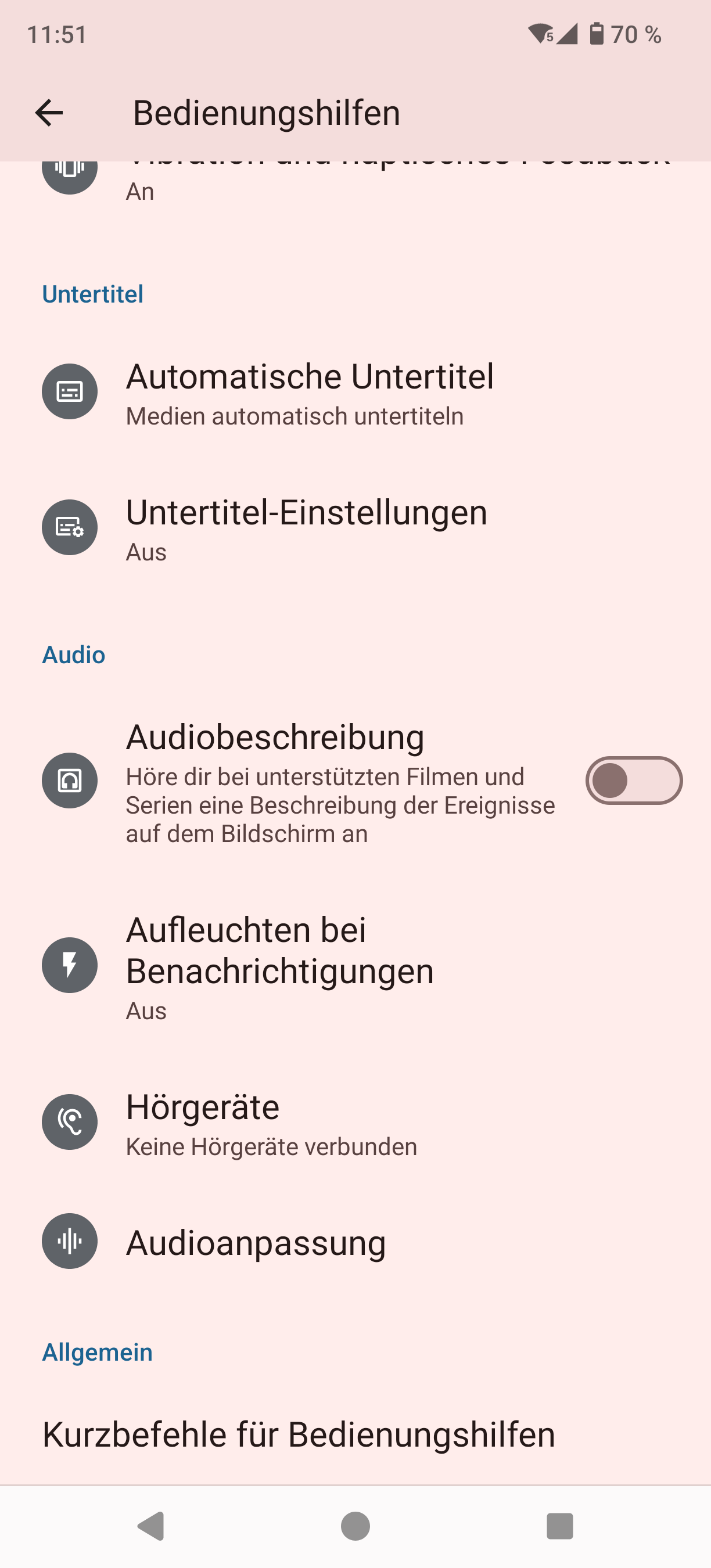

Although I´m not using hearing aids, I don´t find these points in Settings - Accessibility. Just Audio adjustment with one option “Mono audio” and it´s off.
