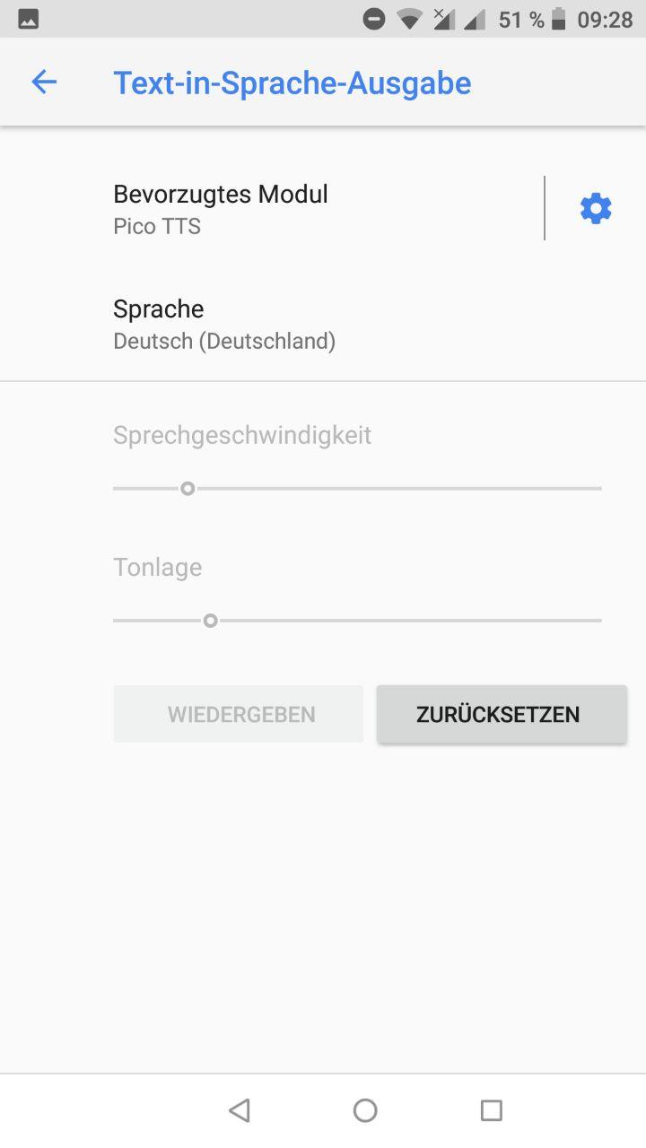

I have again problems with Pico TTS. It is simply silent. I cant download any voices when i go to the options (they are grayed out). Other TTS like the one from Google work without problems. Sometimes other buttons are grayed out too. But even when they are not grayed out and i tap on it nothing happens.
I had the problem already and tried different TTS apps and after a while Pico TTS suddenly works. And now it suddenly doesnt work again.
Edit: After the Update to 07.01.19 it works again. But the languages are still grayed out.
A few days ago i deleted /system/media/ui to get the screenshot sound away. Maybe that was the problem.
