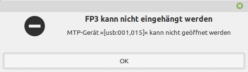

But it does not matter at the moment, I have a more urgent problem, I really bricked the new FP3 which I was preparing for another of my children. I made the mistake of doing step 4 “erasing all data etc” in the wiki https://wiki.lineageos.org/devices/FP2/install and now when I start in recovery mode to apply the LineageOS installing zip, I get the notice on my PC "grafik I am just working on defining what the situation exactly is at the moment, it seems that even a factory reset does not work any more. When I boot the FP3, I get this:
which basically allows me to use google to telephone :-((((
I will continue with this in the appropriate thread.
No reply but an amendment. I got Lineage OS on the new FP3 now, so it is not bricked :slight_smile: But I could not install the Lineage-MicroG zip, (ErrorCode::kDownloadMetadataSignatureMismatch) … Installation aborted. But the regular Lineage OS zip was accepted. So am extremely relieved now, and I will go on trying tomorrow after work. AND I am going to copy this to the correct thread - this one here is the thread for my own FP2.
