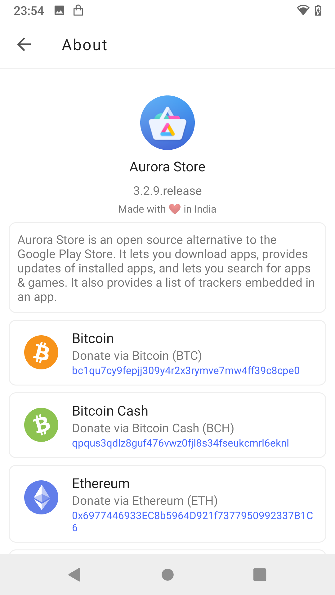

Sure. Aurora is safe for installing apps AFAICT.

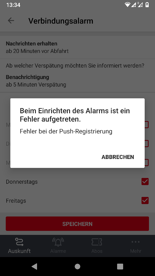

Hi AnotherElk, thanks a lot for your answer, however, it will not allow me to install an “alarm”. I get the following message:
. But this will not stop me using Lineage_MicroG :smiley: :grinning: :smile: and one more thing: I can see how busy you are replying and helping everywhere in this forum - THANK YOU!
Have you ever tried running the Self-Check in Microg Settings? What does it show? If everything’s marked as OK in there, push notifications should work

Sorry to be so late to thank you for your input, but I was reluctant to post a negative answer and I was still hoping but up to now, even after the latest Lineage-Update) it is the same message: “Fehler bei der Push-Registrierung”. The Self-Check in Microg settings shows all green ticks, so nothing there. Maybe it is connected to my other problem, when I switch off data connection after having checked my emails, and swipe it on again, it will often (or never, but I am not sure of that) not connect again unless I restart the phone. But as said before, I can live with that.
I don’t use this myself, but perhaps registering manually would be worth a try …
