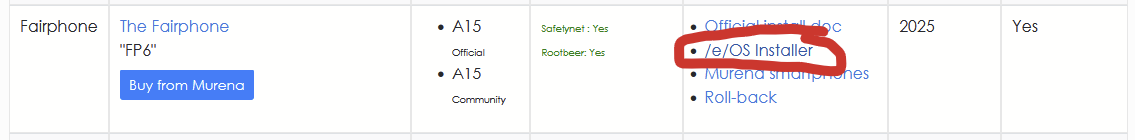

Their device list says the FP6 is supported by the installer.
