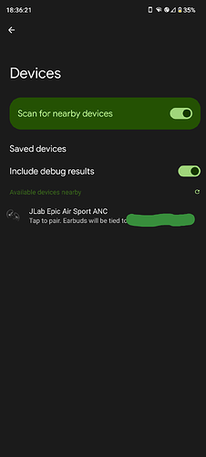

You can check this on Settings → Google → Devices and sharing → Devices

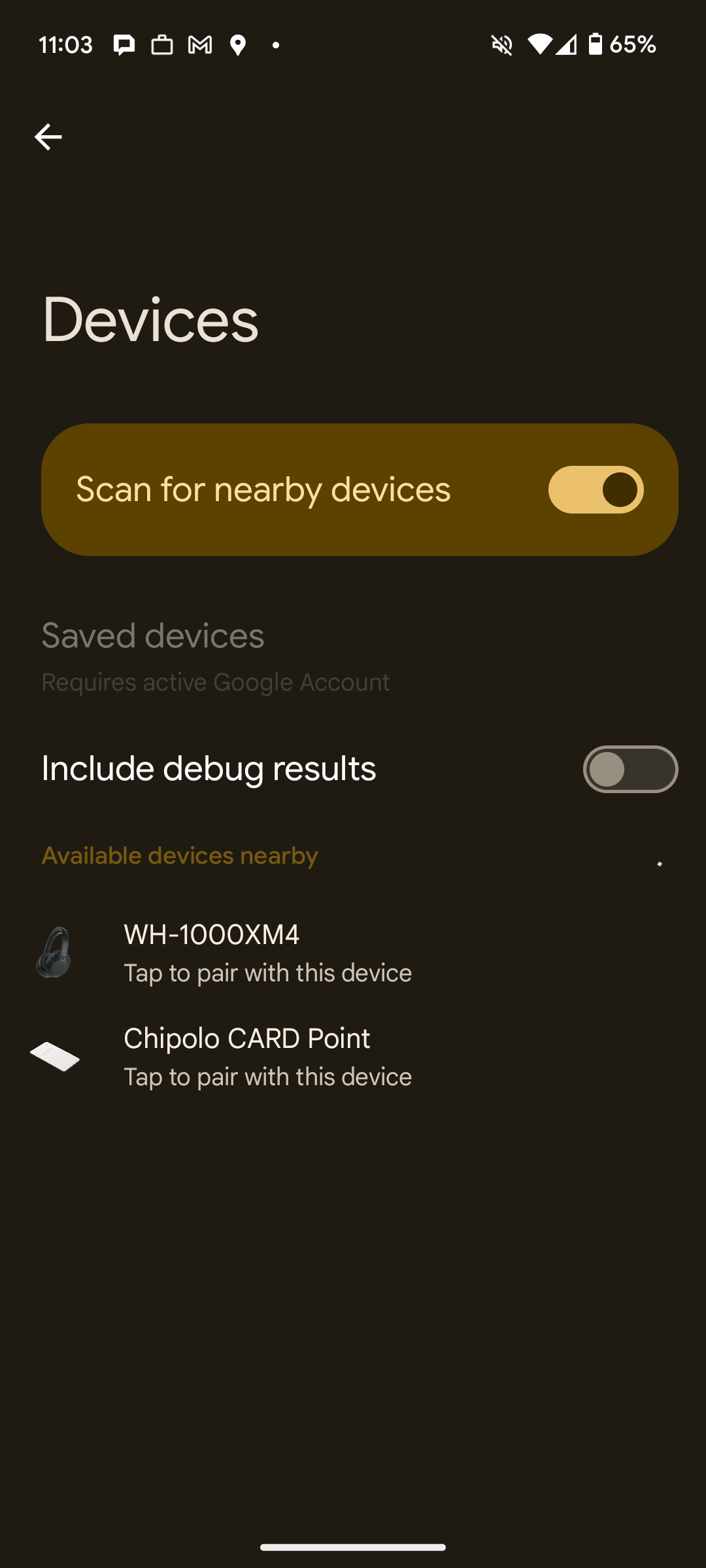

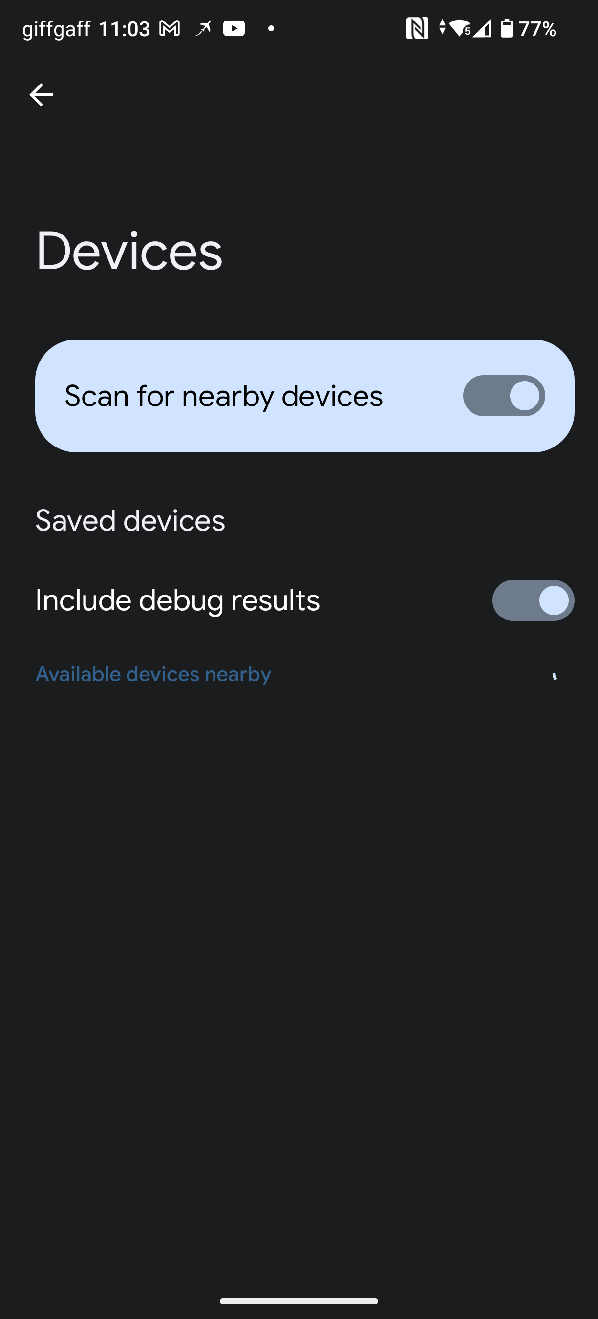

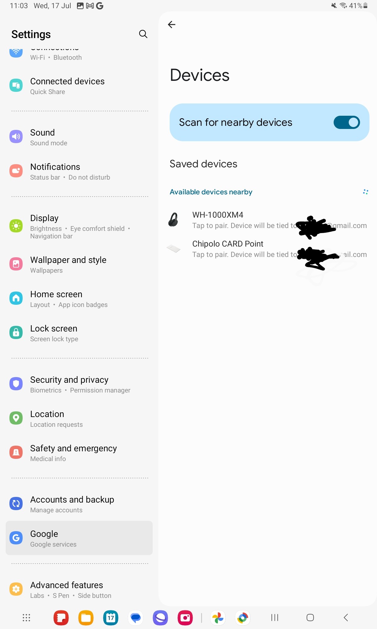

I took the following screeshots on (in order), my Fairphone 5, my Samsung Tablet, and a old Pixel device. I took them exactly at the same time, all near to each other and with Bluetooth on, while I setup in pairing mode both my XM4 headset, and my Chipolo tracker.
You can see that Fairphone doesn’t see the devices:

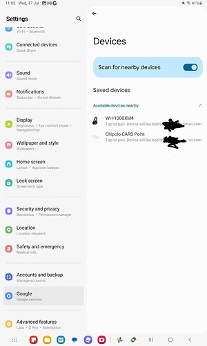

While my Samsung tablet does:

And the old Pixel also finds them (I’m not logged in on my Google account on this device, so that’s also a variable excluded here).
(Screenshot removed because new users are allowed a single media upload here in Discourse, will add it back later)

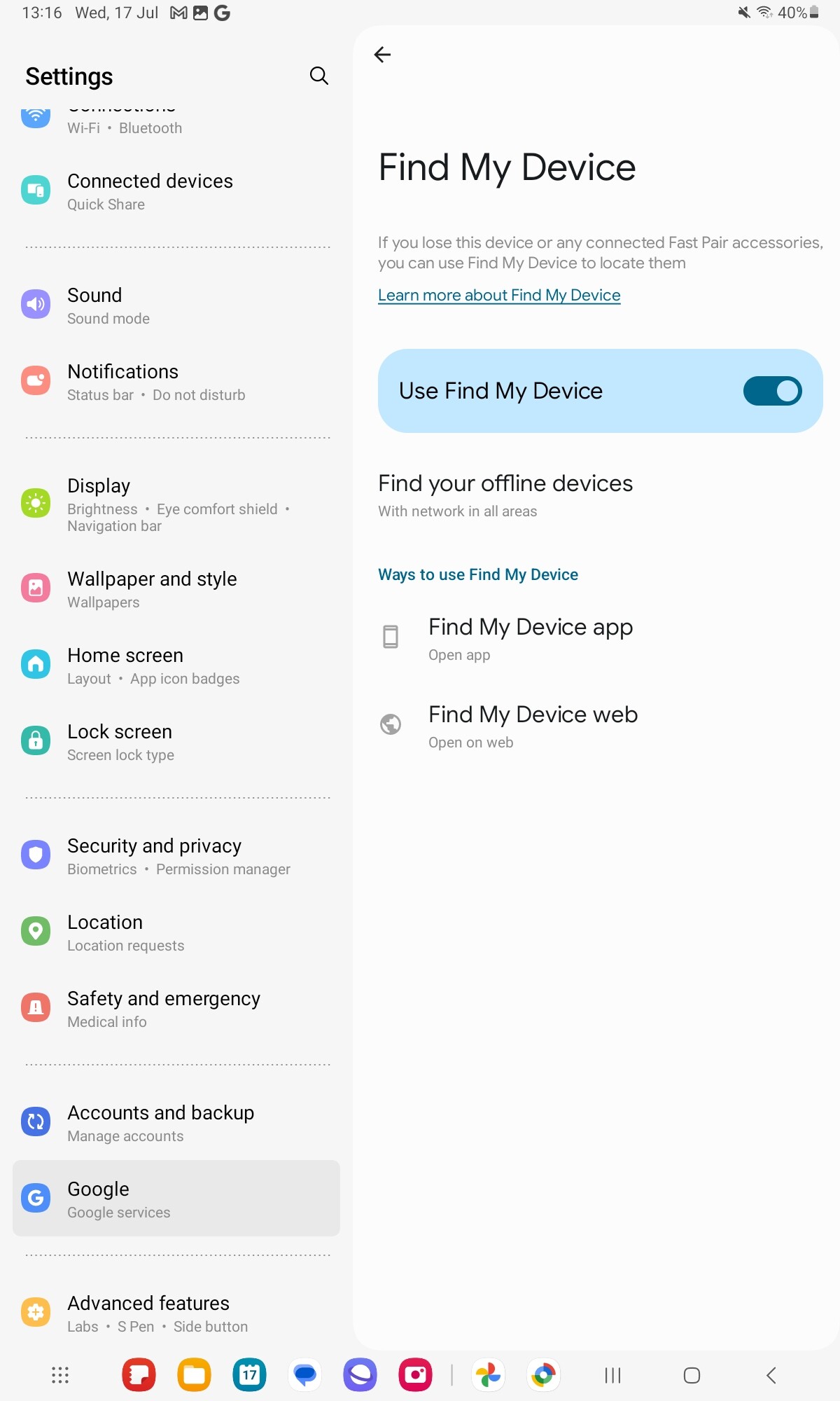

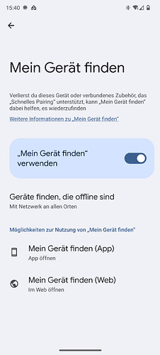

This is how the “Find My Devices” settings should look like (as from my Samsung tablet):
See the “Find your offline devices” setting, which allows you to select the granularity at which your device will log and report beacons.

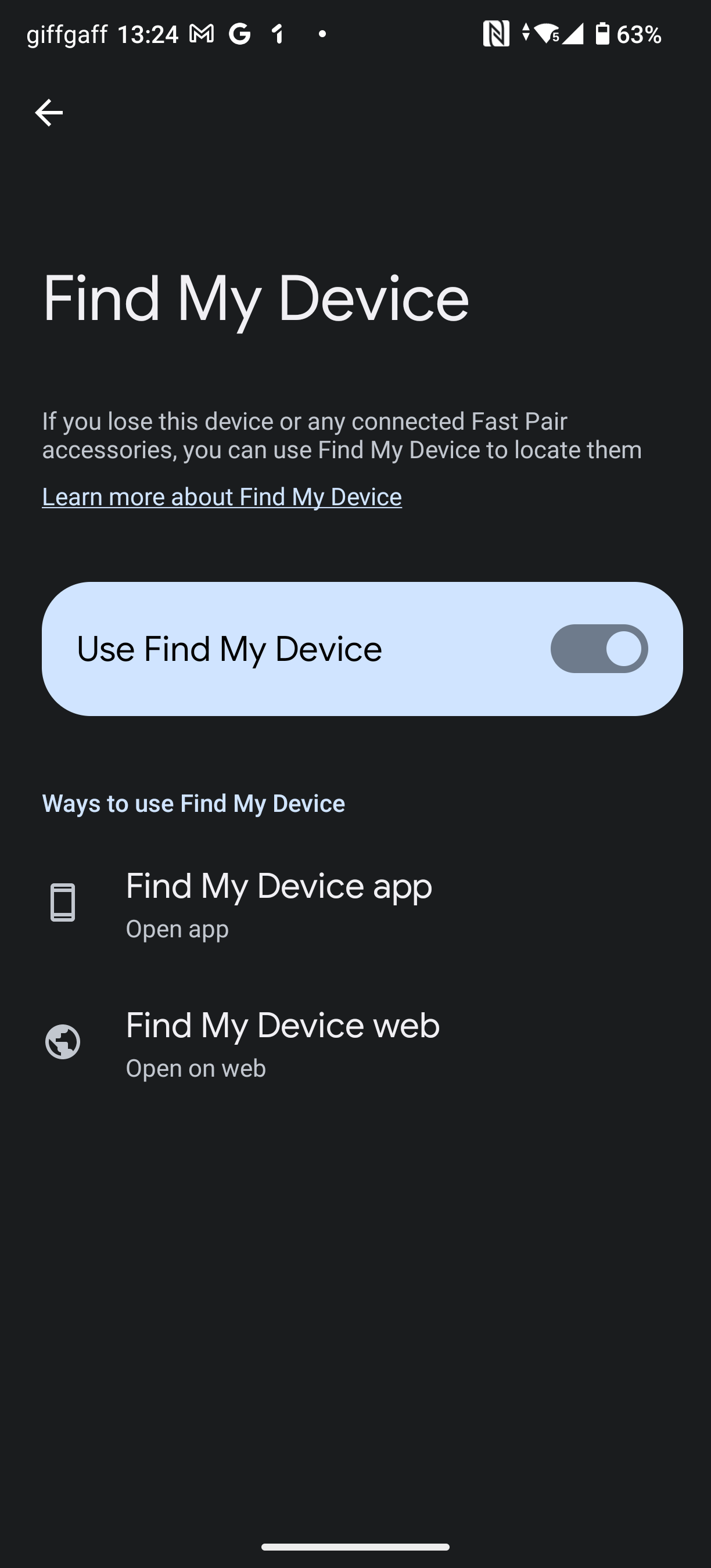

Compare with my Fairphone 5, where the option is missing:
PS: I tried that before updating Google Play services, after updating it, it asked me to provide the unlock code for another one of my device, and the different granularity settings finally unlocked.
