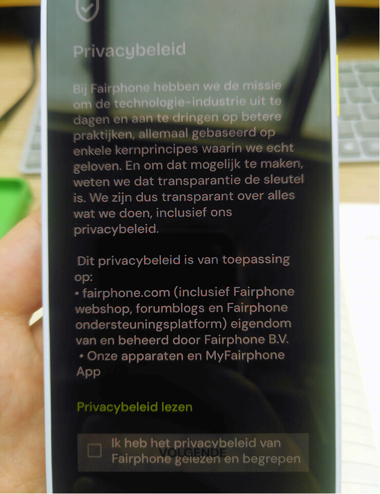

Trying to set up my new FP6 but I’m stuck on the Privacy policy. There is no way to check the box. Has anybody worked out how to do this? HELP!
Clicked at the privacy policy and Scrolled to the bottom? The button should be clickable then
Yes scrolled to the bottom, but that doesn’t change anything, the box remains unclickable.
Guess you are the first to be in the set-up… This seems to be a Fairphone “My Fairphone” App related thing? Is this coming during initial set-up where normally (only) all the Google stuff pops up? This is really mandatory?

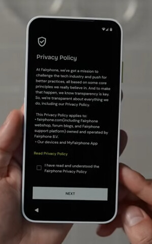

Taken from https://youtu.be/CisekVETaak?feature=shared&t=328
The difference here seems to be that the checkbox and the next button are not overlaying each other. Can you scroll some more so that both elements are not overlapping?
It’s all guesswork but maybe a workaround is to use English as language like in the video and see if it works then?

how about first going with US/english only as a language and only changing later on.
these softwarecompanies… lol…
p.s. can you report back if switching to a different language during the very fist stages of android setup or switching to english even, remedies your situation? could bet it works with english or so. what a pity with these software companies and their software quality control (none).
Thanks guys, it worked! Changed language to English and now the checkbox and button weren’t overlaying. Will change back to Dutch later.

I had the same problem with F6, installing in Italian.
I solved it by going into the settings and reducing the font size: that made the buttons visibile and the tickbox clickable.
I guess they did not test that screen well with all languages.

I am having yhe same problem. I have the English, tried changing the language but it still wont work
Actually managed it by increasing font size to the maximum
Do the boxes overlap as in the picture above?
Yes they did, managed to separate them by increasing the font size - what a palaver - not a very positive introdiction to the fairphone!
