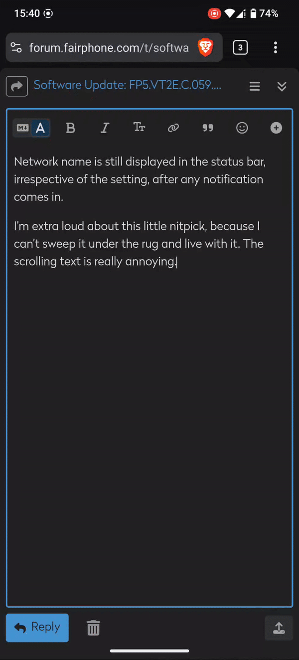

Network name is still displayed in the status bar, irrespective of the setting, after any notification comes in.
I’m extra loud about this little nitpick, because I can’t sweep it under the rug and live with it. The scrolling text is really annoying.
And the VoIP/HD ready notification also still pops up from time to time.
For me, simply expanding and then collapsing the notification centre again is enough to make the network name dissappear—so this bug not that annoying, at least for me.

Yeah I know about that. I am glad it’s easy to make it go away. But when a group chat is particularly active, pulling down the shade regularly is still mildly annoying.
Just wanted to demonstrate how it looks in practice.

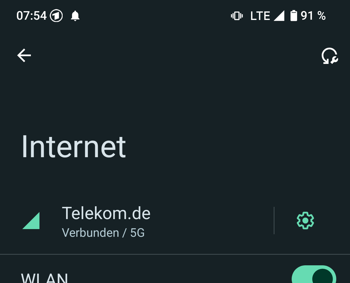

Since the Update to FP5.VT2E.C.059.20250908 Info Not get any 5G Connection, Maximum i get is LTE.
Did this someone else recognize?
Enable the developer settings, search for “Prefer 5G NR Mode” check if its set to SA and change to NSA +SA.
Might be it resets to SA.
Thx, IT was Not reset, but found a solution, went to Network settings deleted them, restarted the Phone and the Phone Set the Sim Standard Settings, now it works, but I think this shouldn’t Happen for Standard User that are not in the Testing group.
What was not reset? And btw you currently comment in the public forum.
You have weiten “Might be it resets to SA." There was still NSA +SA.
So I tryed IT to deleted the Network settings and forced that the FP hast to Download the SIM Networkinformation of my Provider

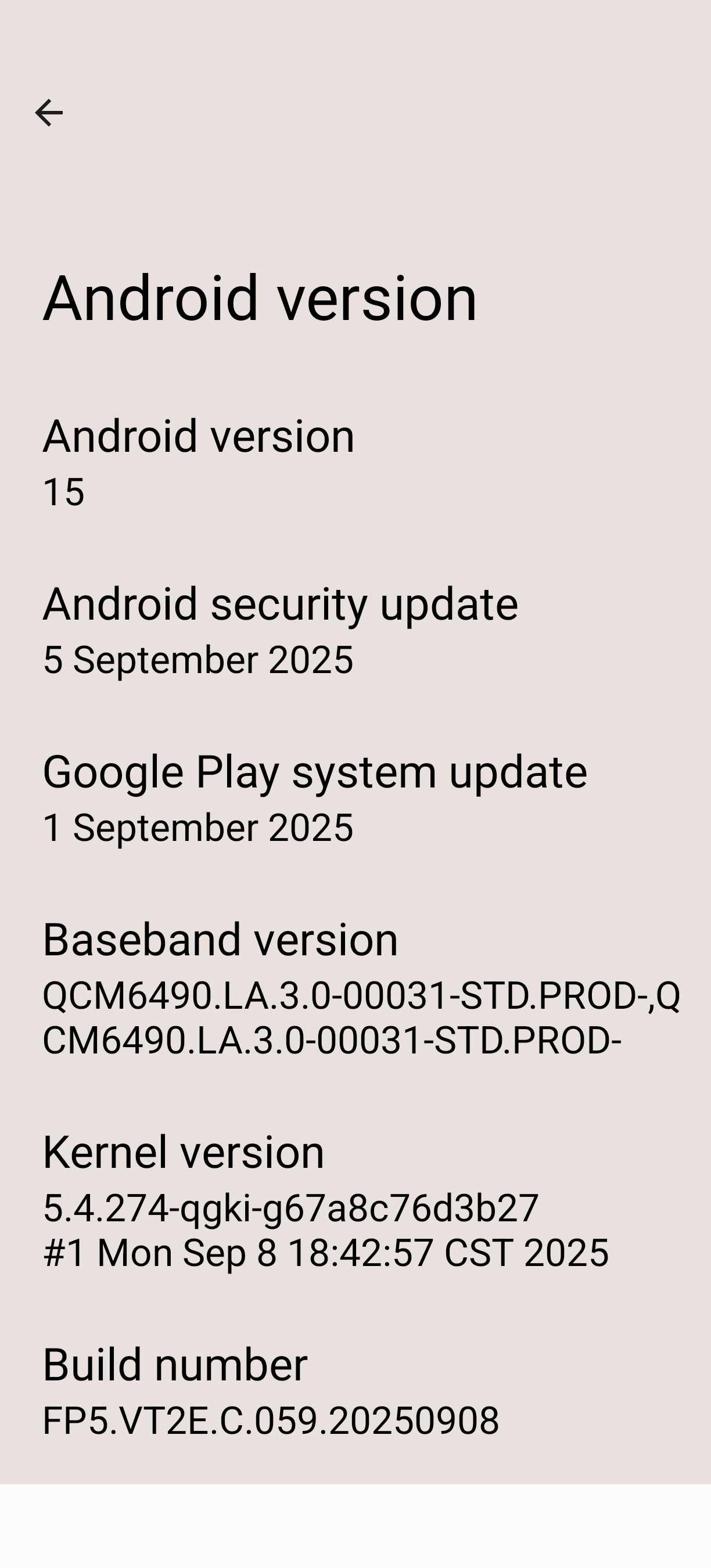

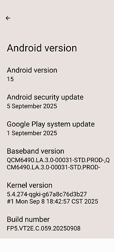

Can someone who’s installed this update give a screenshot of, or describe fully, how it reports itself in Settings / About phone / Android version?
(I’m hoping for clues to help spot when material from this Fairphone OS release, with its fingerprint sensor fix, eventually makes it into an /e/OS release. Particularly interested in “Vendor security patch level”, I guess.)
Is that you’re asking for?
Thank you, yes.
(/e/OS has a “Vendor security patch level” item on this screen, but I guess that’s /e/OS specific – sorry, I’ve not used the stock Fairphone OS.)
