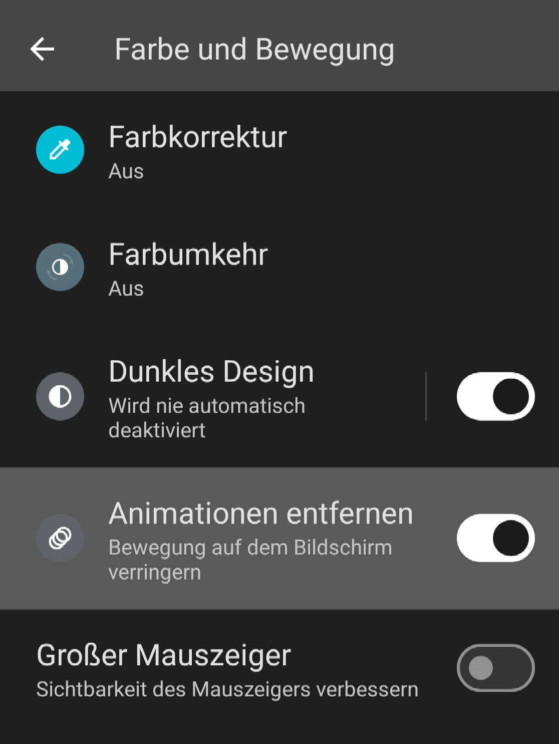

Disabling the animation did fix it for me.
Seems the UI (Animation) is so slow it will open the first app of the default app list.
At least this is what happened to me :wink:

Thanks, that also works for thr FP5 issue!
Seems like it’s an error they have been carrying from FP4 already.

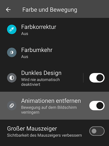

In English, go to
Settings > Accessibility > Colour and motion
Enable Remove animations.
