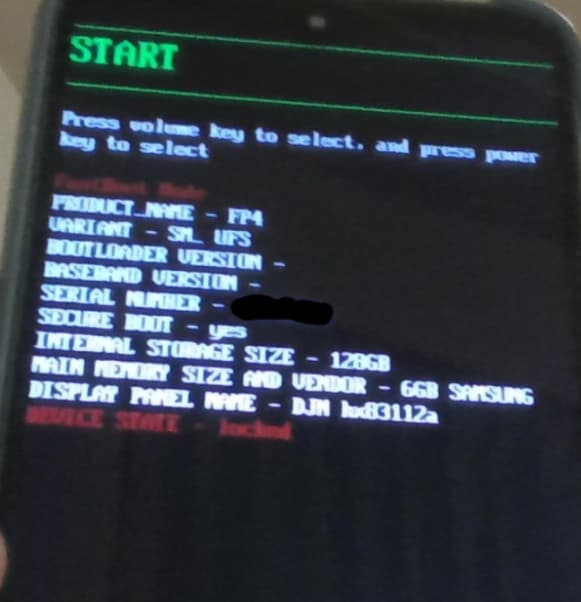

Also, here is what the fastboot screen looks like (image quality is not great, and not sure why it says Samsung):

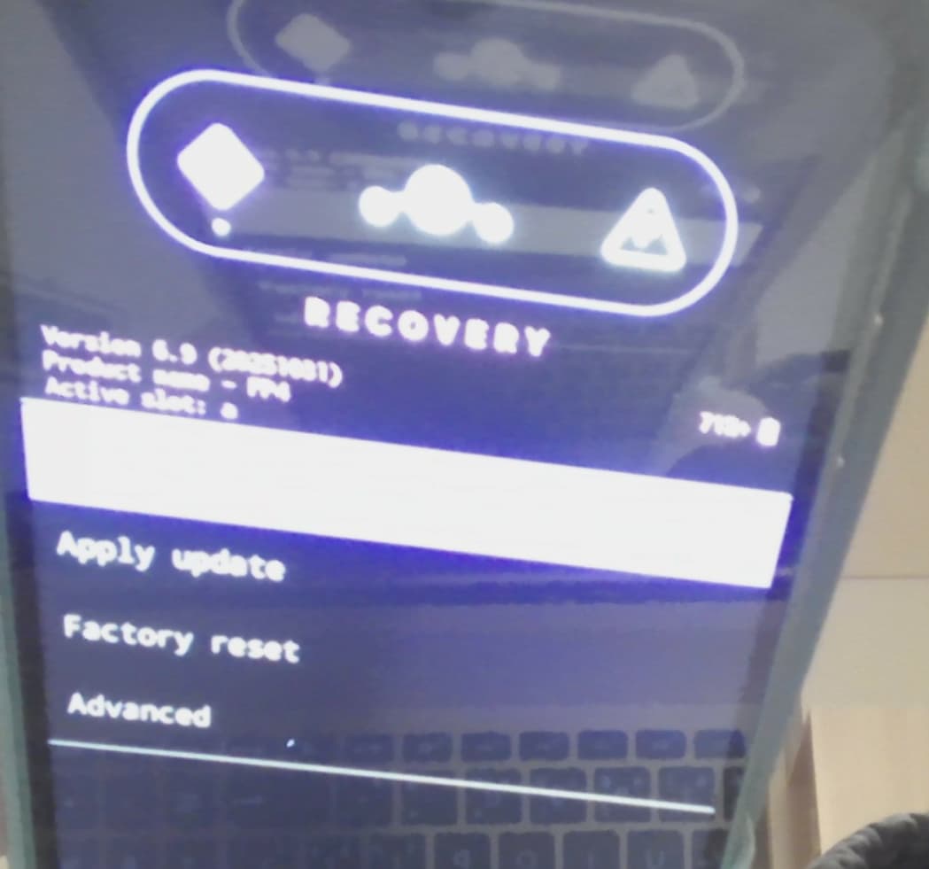

And the LineageOS recovery screen (text says Version 6.9 (20251031), Product name - FP4 and Active slot: a):
I’ve seen Active slot: say b as well. Not sure if trying to run fastboot --set-active=b caused that (me thinking maybe there is some other OS in the other slot, which was really a guess as I have no idea how this works). But that didn’t seem to complete succesfully.

That’s just the vendor of the memory
Don’t touch the slots, ever, unless you absolutely know what you’re doing and why.
The slot you’re in will get managed by the system and is an important part of automatic disaster recovery, changing it can make your system unbootable in some cases, they’re not meant as a user accessible way to roll back to a previous version.
