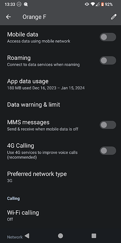

Did you try VoLTE, VoWifi off?
Which OS do you use, there was not A12 from Fairphone itself.
Yes I guess so. Please see attached configuration screenshot
