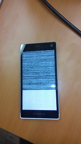

I’ve got a “noisy” screen on one of our company phones:
So maybe we can examine this on our next meeting?

EDIT2: I got it working once more for a few hours after taking apart and cleaning, then back to noise. Here’s a fun close up of the screen. I actually heard back from support pretty quickly which is good.
