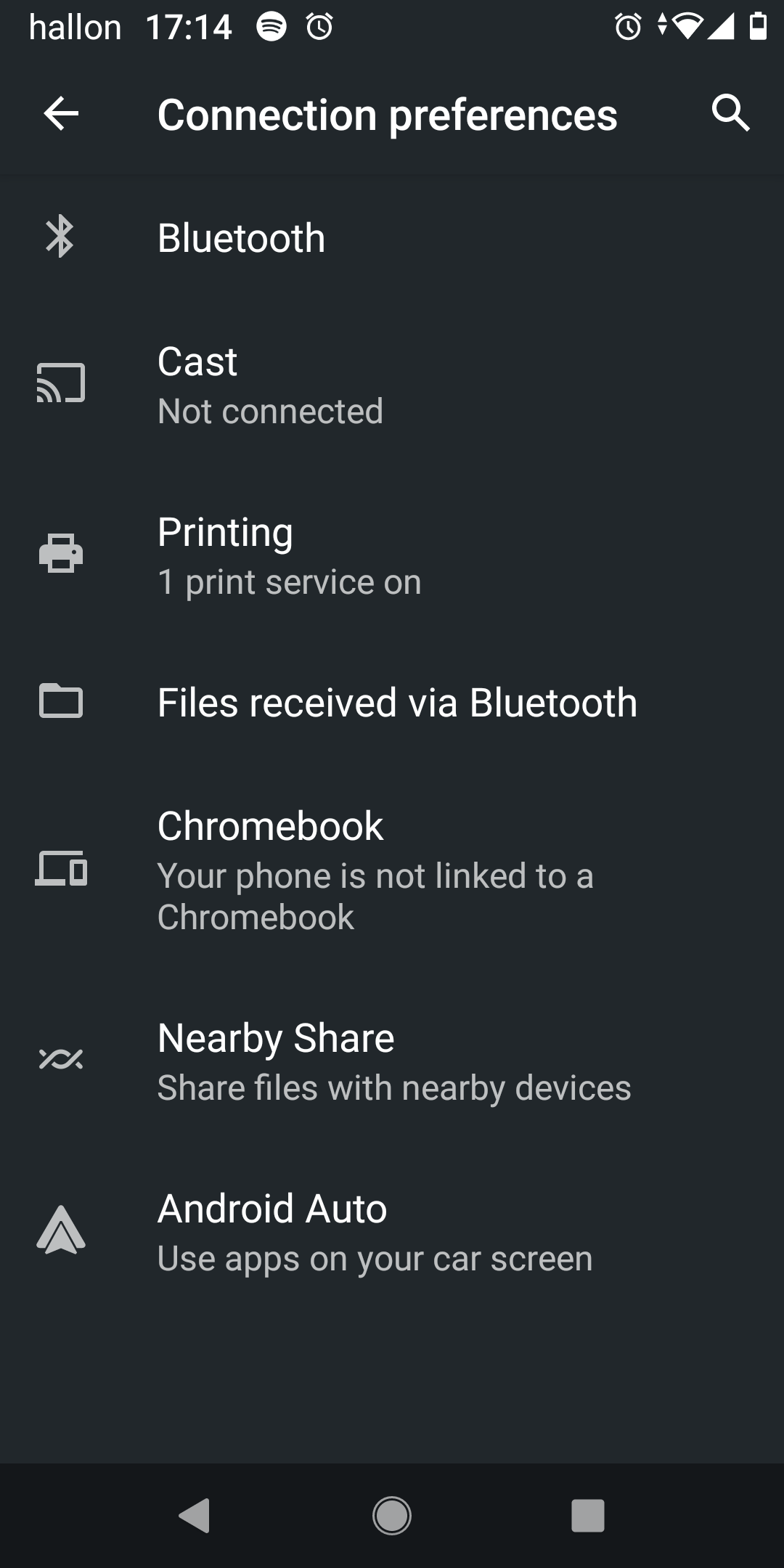

I don’t have the setting at all under the Connected devices/ connection preferences.

On my FB3+ I went to Settings, Connected devices, Connection preferences, below Bluetooth is NFC, it is either ON or OFF, I expect it is the same for the FB3, if you are running Android 10.
