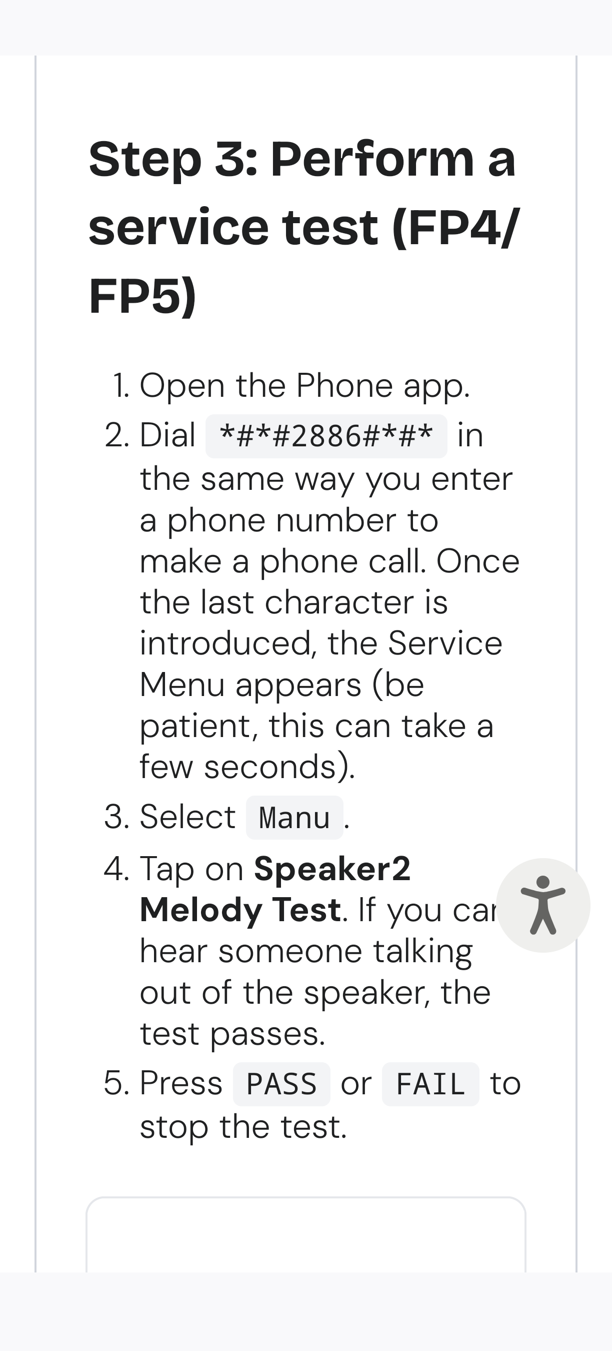

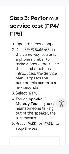

How about this test?
Do you mean literally a few seconds, or is it an euphemism for a longer time such as half an hour, hour? I’ve waited a good while, approaching that half an hour mark, and nothing happens.
If that’s unexpected, I wonder if there’s a software issue causing it? My fairphone 4 is updated to the latest Android 15. Could that make this command not function?

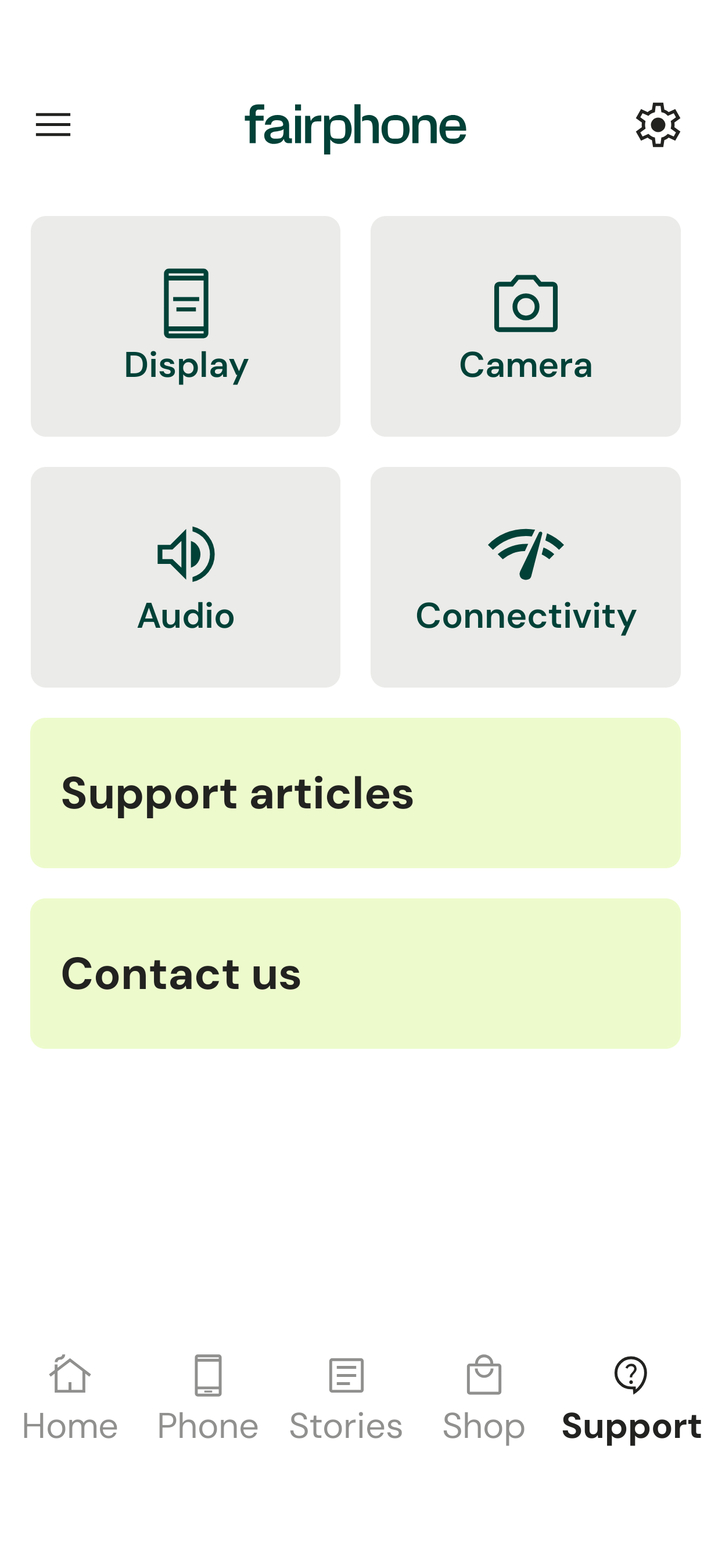

You could try checking support and testing section via MyFairphone App, perhaps audio is there included (it is for FP5)
No worries, and thanks, I hadn’t even taken look at this app. Well, my phone failed both tests.
