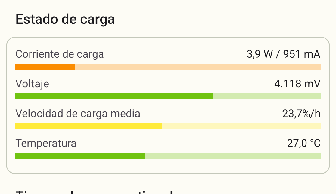

I think it is not commented here, but with 15.151 software looks like slow charging works now. Tried a fast charger in my phone and remained slow.
So at least one less thing to worry. It should not die like that anymore.
