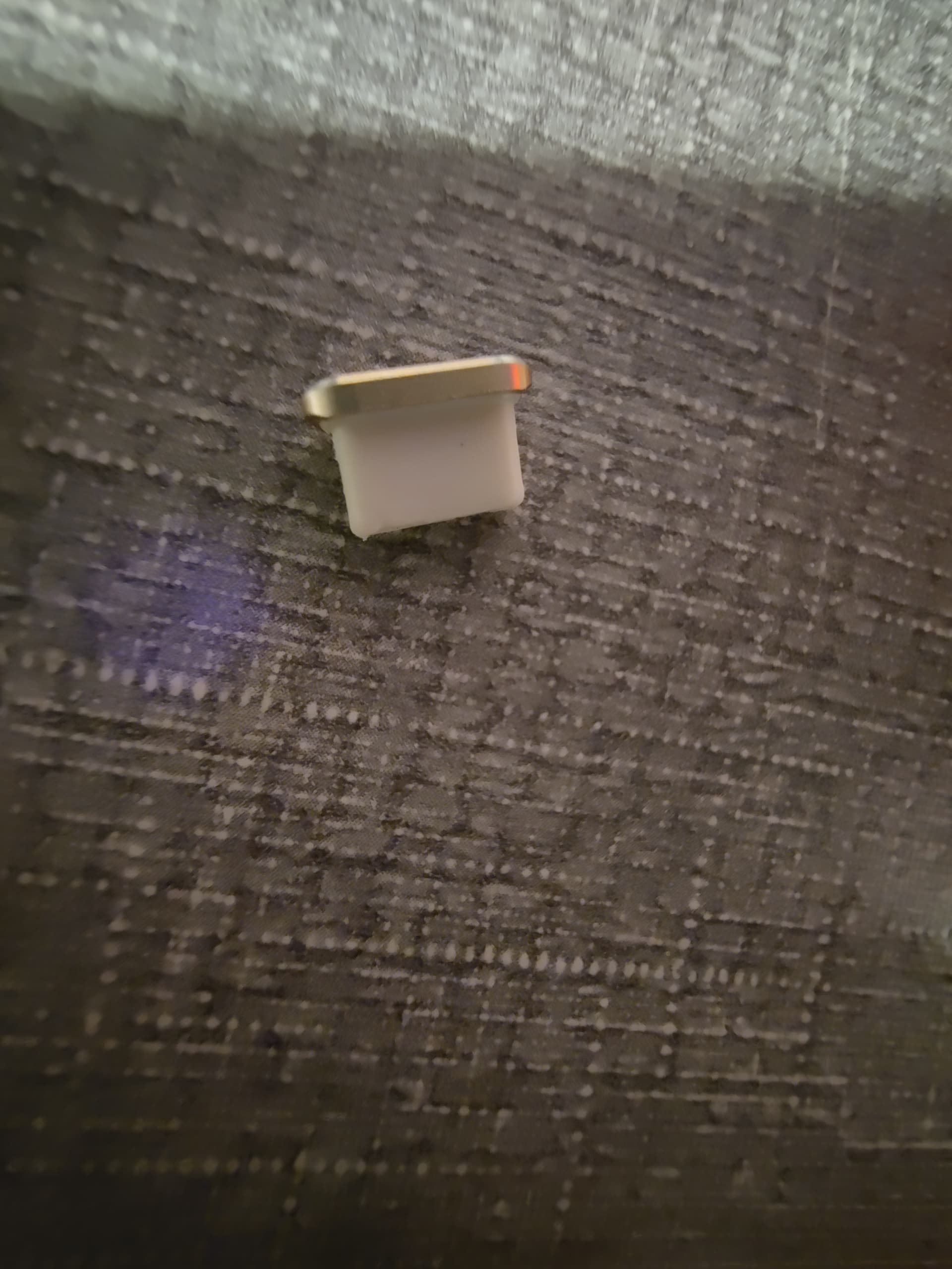

Not sure how relevant that is to the topic but as I read quite often about people needing to clean their USB port, I have decided to share my solution.
I am using the silicone/plastic protectors for USB ports. They are quite cheap (1 euro?) and easy to replace. For devices that I need to charge often, I use the ones with the sticker, for a headset ones without one (see pictures).
I know magnetic cables have also been recommended on the forum but that felt like a bigger operation (changing cables as well). I think magnetic cables are better in terms of general protection from pressure, while silicone plugs more weatherproof.
