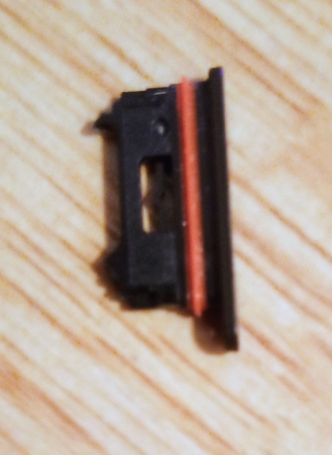

Today I wanted to install a memory expansion in my Fairphone 6. Since I couldn’t find the original SIM tool, I used a paperclip. However, this only removed the cover, not the entire SIM card tray.
Where can I get the original SIM card tool, or is my SIM card slot/tray defective?
Fortunately, my SIM card is still recognized.

It seems the SIM card holder is broken. I found the original removal tool and when ic use it, only the top cover comes out and the SIM card and tray stay inside. and SIM card is detected.
So what can I do?

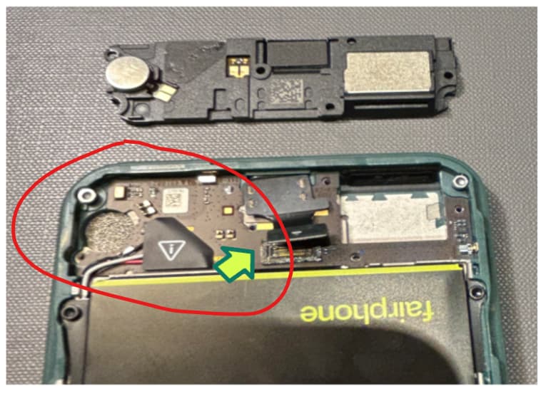

Now dismantle the loudspeaker, USB-poort and the display. Perhaps you can now reach the SIM cardholder. And see whether the holder is broken or if you’re lucky it just became loose.

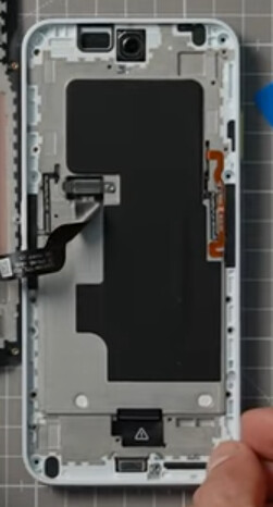

I tried to check the tutorials for replacing the USB-C port and I believe it is there
but I am not able to locate it on pictures when the display is off
Perhaps someone with the FP6 would be able to help and confirm?
thats def not possible you need to get this out first.
I dont think its advisable to try to bring this out by opening the phone (see at 3:06), as the bottom core module part need to be “opened”.
I just dismounted both the speaker (on the one side of the phone) and the display (on the other side of the phone) and can only confirm that the card tray goes inside in the midframe without even being visible from either “naked” side. There seems little point in me making photos as all what is visible is already in the photos that Meaghan linked to:
The card tray is BELOW what is visible in the red circle in the first photo here and BELOW the near-squared grey area in the lower left corner (to the left of the black and white warning sign) in the second photo here:
I also tried to measure how deep the pin goes to eject the card tray and this should be around 8-9 millimetres.
