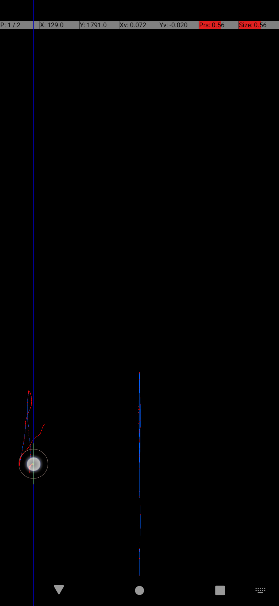

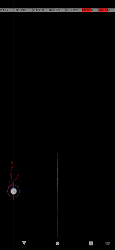

Got ghost inputs for about 3 weeks now. Activated touch visualization after that and this is the first time I got it screenshotted. The touch left is where I was typing and in the middle is the ghost input.
