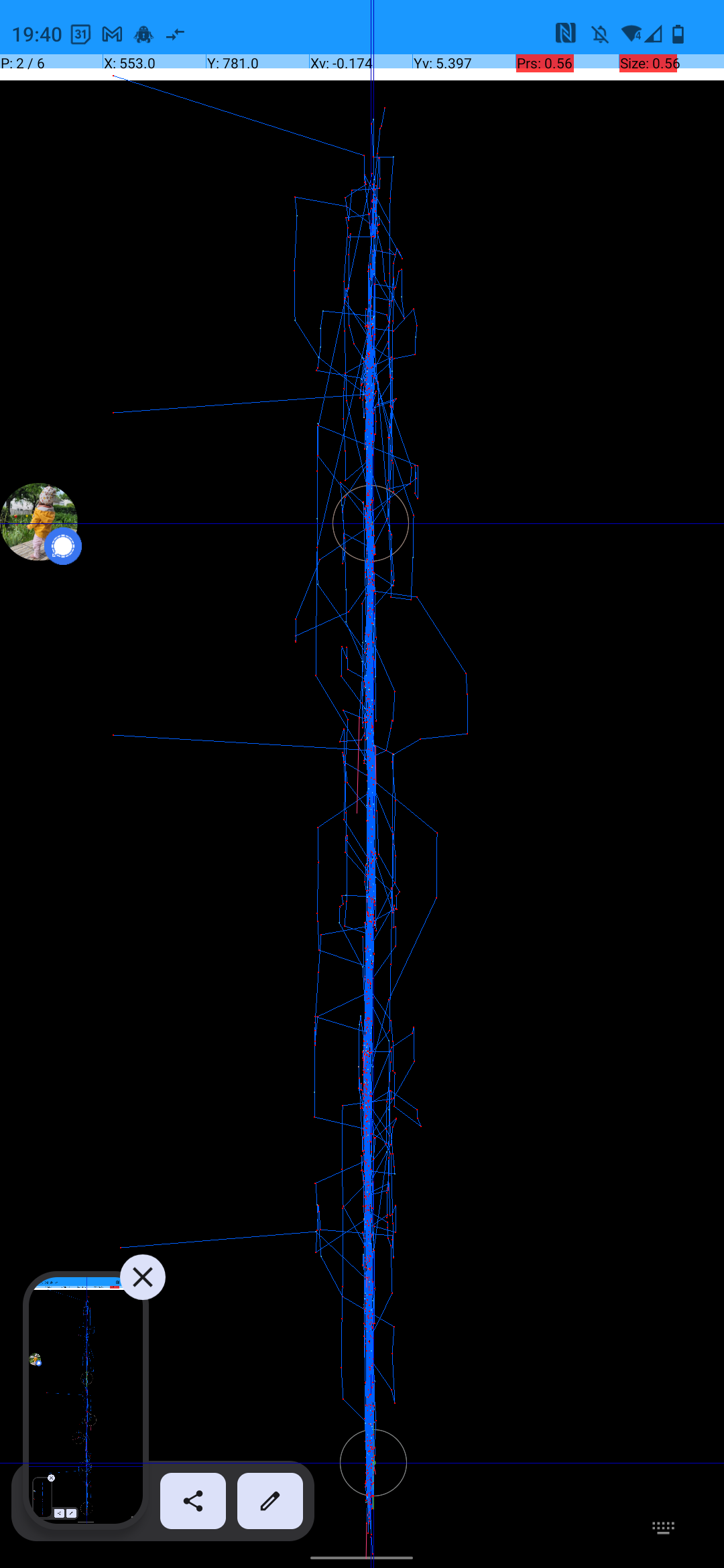

Does anyone else have any experience with screen jitter and random inputs or swipes?
Randomly throughout the day my wife and I will experience random inputs and swipes, and locking/unlocking the screen is the only resolution.
