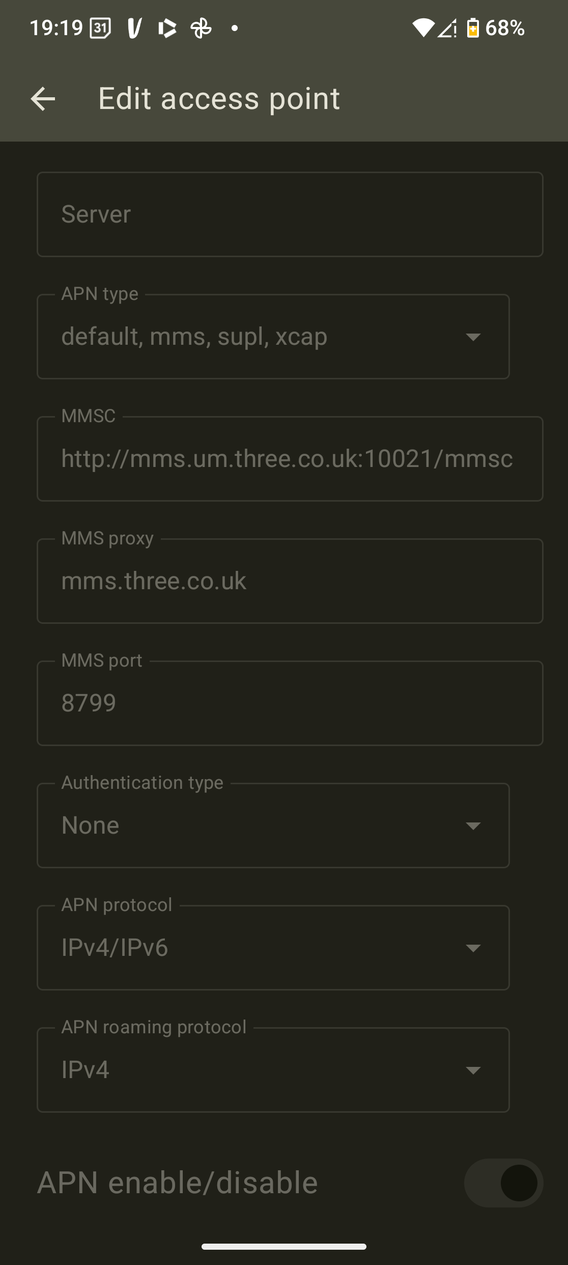

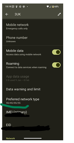

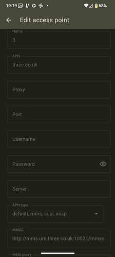

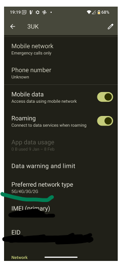

I’ve taken a couple of screen shots which might answer the APN/4g settings better than explaining in words.
As far as I can see by looking through the Network Settings tabs, I can’t locate any details of the 4g/5g settings, only to confirm that they are selected as the preferred network type - pictured.
I’ve also taken a shot of the APN settings. I don’t know what they should be, so am relying on someone else being able to confirm if there are any issues.
Thanks for the continued support.

I am not on 3UK but APN settings look legit to me.
My settings are different with 4G calling feasible, so that could be the question for other 3 users.
But could you change these settings and see if that makes any difference?
PS. Just realised you have shared your IMEI so I will delete these pictures from your post

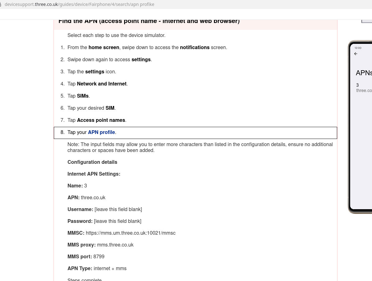

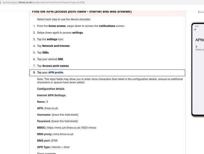

At this page from 3 UK one has to type at the line APN Type
internet + mms
After you have done this. Tap on SAVE at the right upper corner.

just jumping in to ask whether changing the preferred network type from 5G/4G/3G to lower brought any meaningful results?
Thanks Meaghan. I’ve just tried it on 4g/3g/2g and it makes no difference. 3g and below is no longer functional on Three, so I wouldn’t expect results selecting network types below that.

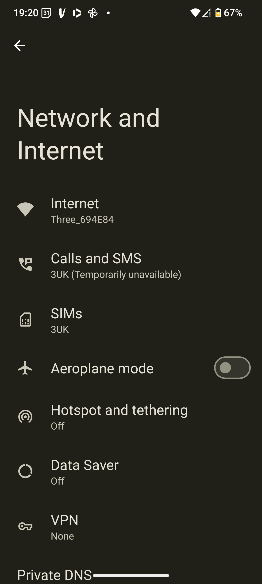

The switch happened a while ago, and as I mentioned earlier, the rest of my family are also on Three network and are having no issues, nor do their sims work in my phone. One of them is using a 6yo Samsung, it would be a fair incitement of Fairphone if their flagship device is being out performed by a relic.
The option to select 4g calling may be under the calls and sms tab, but the subheading says that for the 3UK sim, it is ‘temporarily unavailable’ and therefore I am unable to select and view options.
