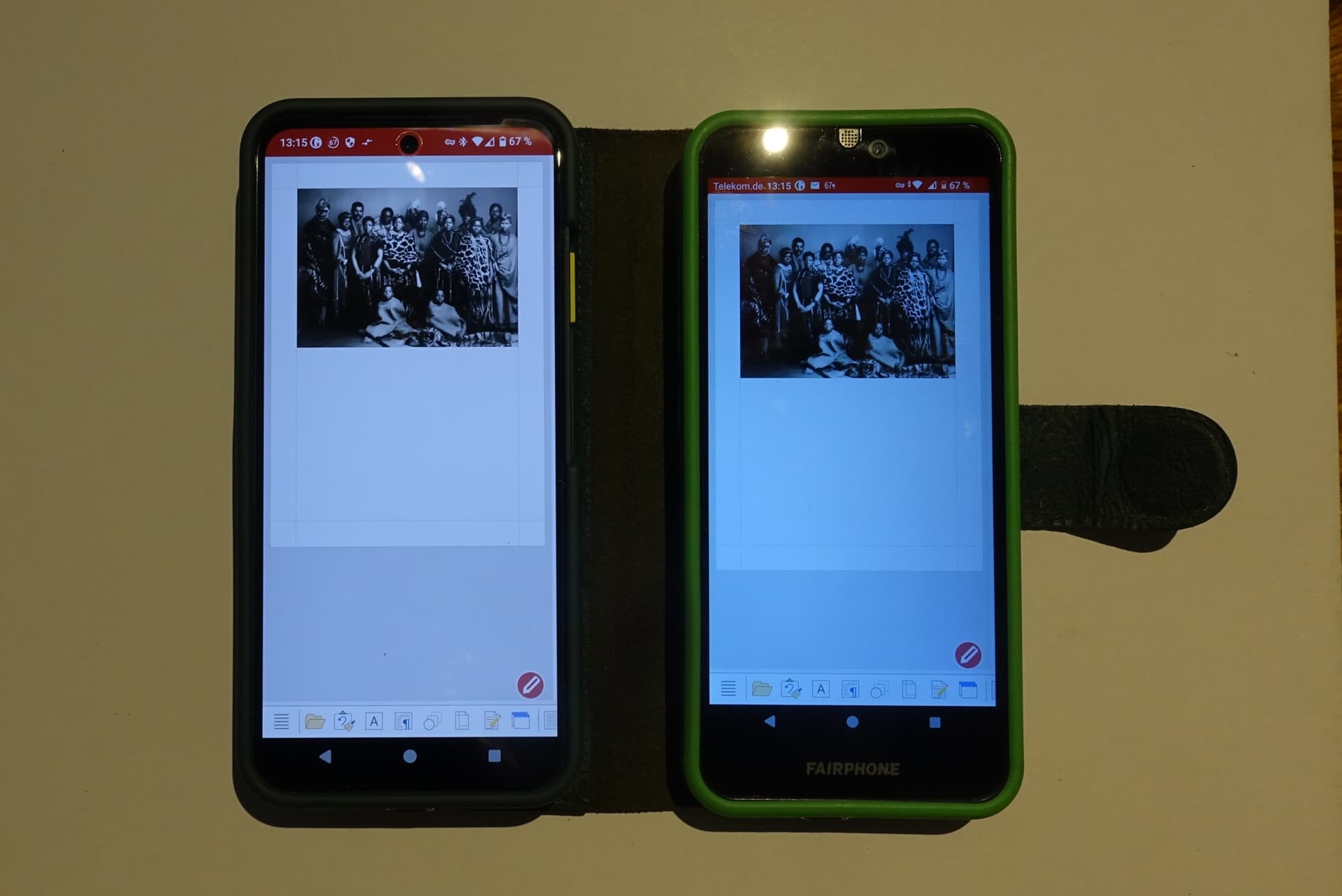

Here’s a photo taken, this time, with a FP5 (my contributions above were with FP4).
There’s not much difference compared with the photo taken with FP4, possibly the FP3 screen below is slightly greener.
But what really surprises me, and I repeat, is the extent to which these photographs of the screens exaggerate their differences.
To my biological eyes, in real life, the FP3 is less blue-biased, AND the FP6 is less sepia tinted, so that the difference between them is in reality much less than as appears in the photos.
It would seem that the cameras are exaggerating the colour balance differences.

Yep. Took another shot with my Sony DX100 IV (settings unchanged, lighting augmented, image slightly cropped):
The noted difference (FP3: cold, FP6: warm) is clearly exaggerated.

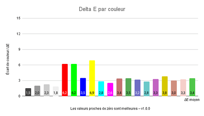

Here is the “delta e” from Fairphone 6 “natural” setting (“defaut” is colder), best screens are those that can display colors with “delta e” around 3 and under and around 6500K color temp.
FP6 has a good screen with good factory calibration.
The calibration of levels is also satisfactory. By default, the smartphone displays a delta E of 3.05, which translates into colour deviations that are barely noticeable to the naked eye. In terms of colour temperature, it reaches 6622 Kelvin, which is very close to the 6500 K of the reference video standard. A quick trip to the settings and switching to Natural mode brings the delta E down to 2.67, with a temperature that stabilises around 6565 K – for purists seeking the perfect hue!
For comparison on the same site, about FP5 screen :
By default, this new panel is not very well calibrated. After adjusting the settings and selecting the “standard” colour profile, the display offers much more convincing colourimetry. We measured an average colour temperature of 6802 K, which is slightly cool, and a delta E of 3.4, indicating deviations in green tones and in the primary colours red and yellow.
Now same site, for the Fairphone 3 :
According to our analyses, the colour temperature is too high, reaching 9,120 K, whereas the optimal temperature should be 6,500 K. As a result, the colours tend towards blue, giving an impression of “coldness”. And colourimetry is unlikely to improve the situation. Its measured Delta E of 4.6 indicates significant deviations. The red, yellow, green and especially blue hues are well above the ceiling – as a reminder, deviations are considered invisible to the naked eye with a Delta E of less than 3.
Very bad color accurate LCD screen, can’t be correctly calibrated
The blue column (10 in delta e is waayyyyy too much) is what makes your FP3 having this cold tainted images, and “blue” black and white pictures.
And your eyes are used to that, your brain “thinks” it’s normal.
But FP6 is right, it doesn’t lie in colors ^^

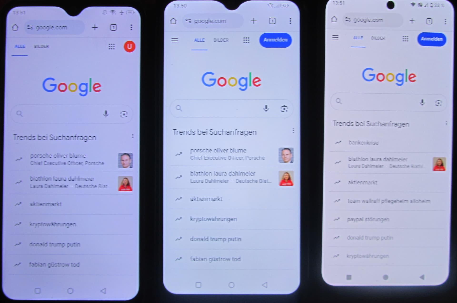

In the meantime, I’ve been thinking about how to easily compare the displays. I’ve opened the Chrome app, closed all tabs, and now I get a white screen with Chrome’s colorful logo. Here are one photo of my three phones. Unfortunately, due to interference with my old camera, this should only be considered an example. In real-life comparison, my old phone (LCD on the left) has a rather cold display. I was happy with it for five years. In the middle, my wife’s phone, the successor to my old phone (i.e., LCD), is a bit warmer and looks almost like the screen on my FP6. And when I look at them all in direct comparison, I like the screen on my FP6 (right) the best. I assume it will take some time (and I no longer have anything to compare it to e.g. my old phone) to get used to the display.
I agree with you that the settings could be improved.
Final question:
How do I reprogram my brain?
It will take time and you must not look at your FP3 anymore. :kissing_face:
