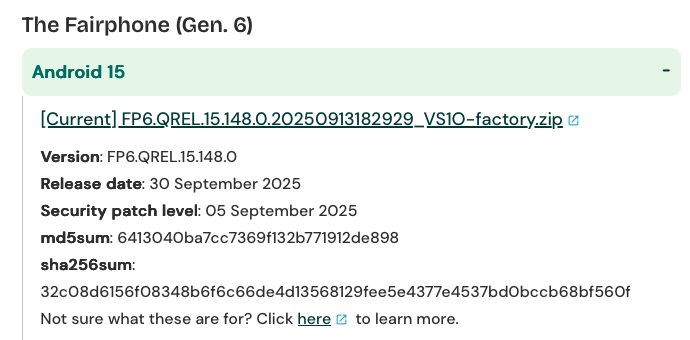

I carefully checked both SPL versions before proceeding, like others in this thread.

FW FP6.QREL.15.148.0.20250913182929_VS1O-factory (listed with SPL 5th of September).

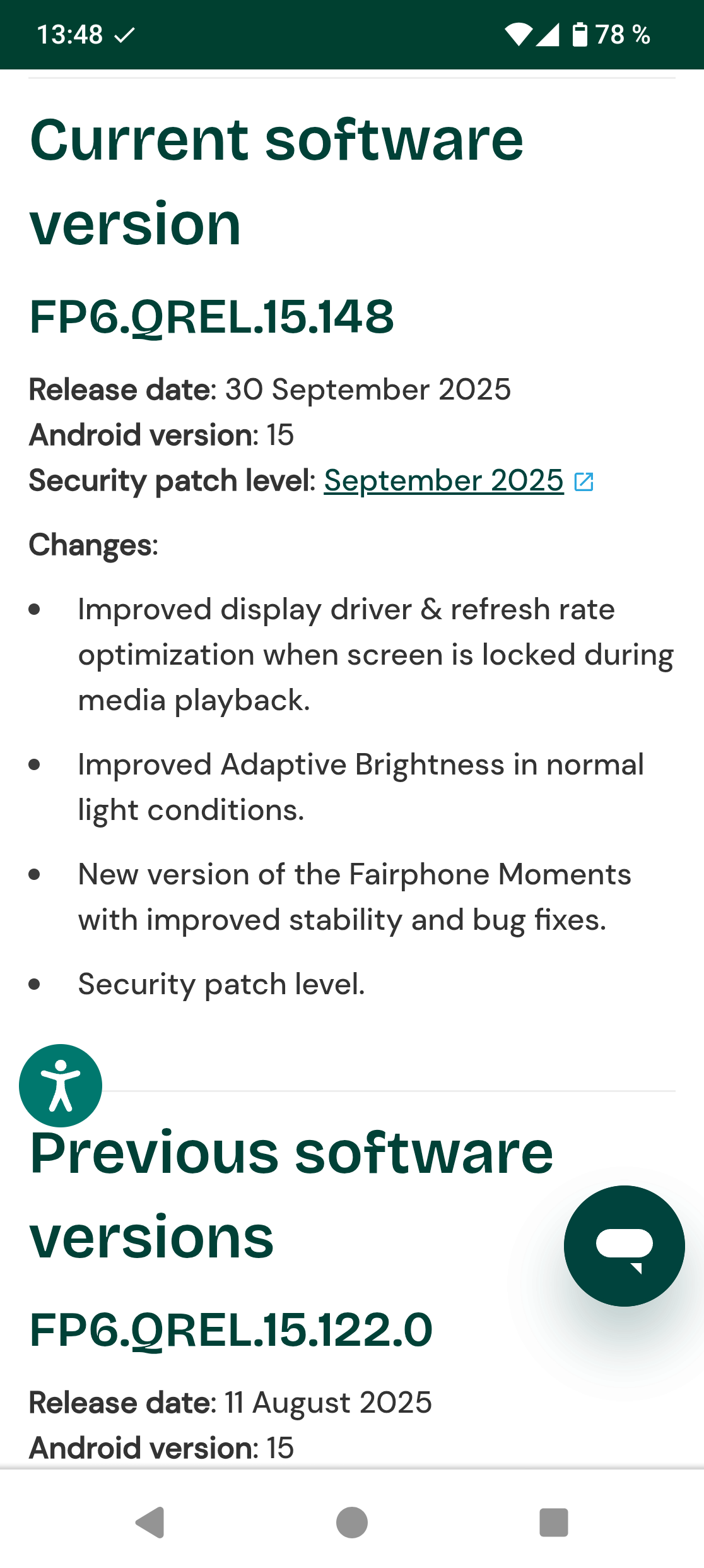

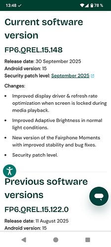

FP6 is not yet on SPL 5th Sep, where is this stated? If officially on any FP side make a Screenshot!

Edit I see SPL is still wrong in the release notes

See above current FPOS has SPL 5th Aug

I’ve had a fairly frustrating reply from support claiming that a third party OS did this, when it’s clearly a direct result of flashing a rom with older security patches, which would not have happened to most of us if the listing wasn’t incorrectly stating 5th September (I notice it has now been corrected).
