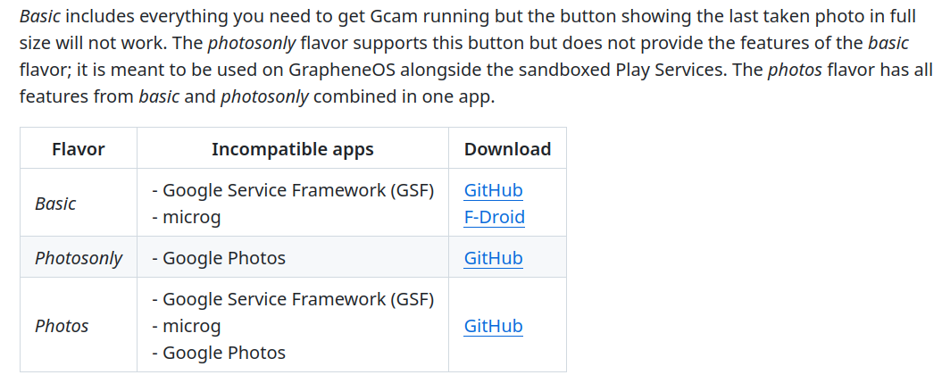

In the apps description it says it is incompatible to gapps and microg. So I doubt it would work on /e/OS. However, you probably meant to share this, which indeed works:
Also Shamim GCam seems to work, didn’t do a lot of testing. But it allows opening pictures in any gallery-app without an extra-app:
No, I mean GCam provider has 3 flavours. “Photosonly” is the one which works in /e/, but is only available on GitHub, not in F-Droid:

the “photosonly” is explained above, but does not mean “not for video”, is just connected to the preview-button…
