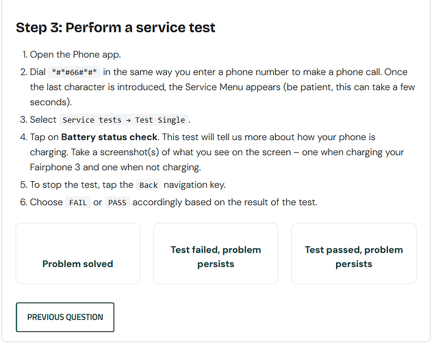

you should be able to purchase one from the shop. But before jumping into that - do you have a MyFairphone App installed on your device, could you run some troubleshooting?
I just have had a quick look on the relevant troubleshooting process via self-repair portal and they also suggest running internal tests - so that could be one of the first steps

Following your link, I went to the battery check and it comes back positive with good battery health. When I plug in the phone it says ‘charging’ but it’s not. It just went down from 3% to 2%.
Voltage is 3.47. It went to 3.60 when I plugged into a wall charger.

In order to avoid any misunderstanding, are we talking about this kind of test?
Are there any differences in results when the phone is charging/connected and not charging/not connected?
Yes, that’s the one.
