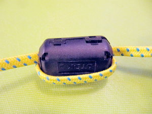

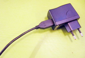

The reason for such behaviour is:
the charger emit high frequent noise with the current and if that reaches the FP2 it makes the phone unusable. In my opinion the FP2 is not ok, because two dozen other phones work flawless while charged with the charger in the images.
the reason is not:
a cable with only two wires for the current. Charging works normal without data-wires.
The solution:
is shown in the picture. Use a calble with such ferrit-denoiser (No clue what the english term is …). I tried to make it clear so I used a cable for 1 Euro and a ferrite-ring from another cable.
The charger: is a cheap Huawei one 5 years old …
Now for the images:
The charger with orgnal cable - the FP2 gets charged but is unusable
the charger with a pimped cable
(without this thing the FP2 is unusable too with this cable)
The term for this thing is “ferrite nuclei” and it works as “low-pass-filter”, that means, it lets not pass signal with a frequncy but DC. If you built a cable like me, then let the wire pass 2 times (or more). And set it as near to the charger as possible …
