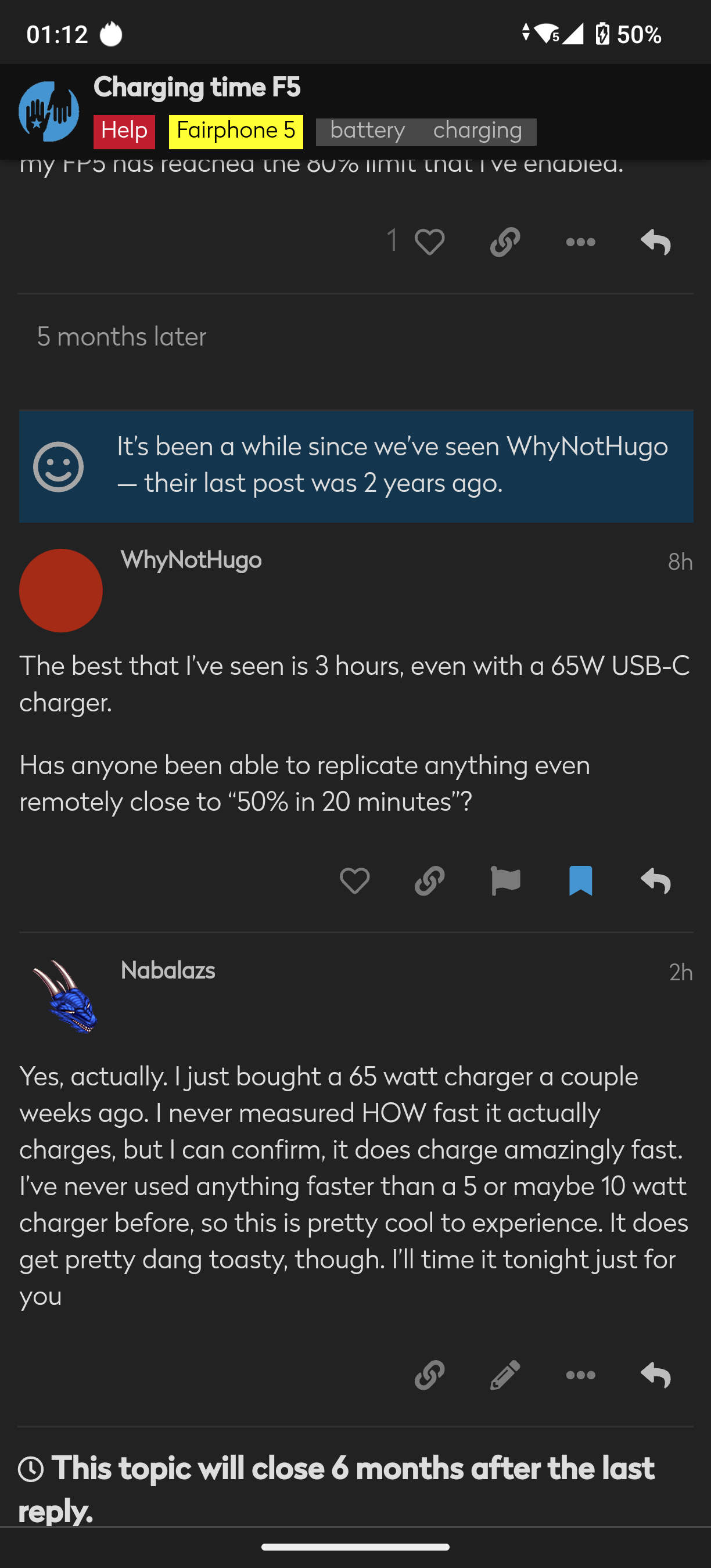

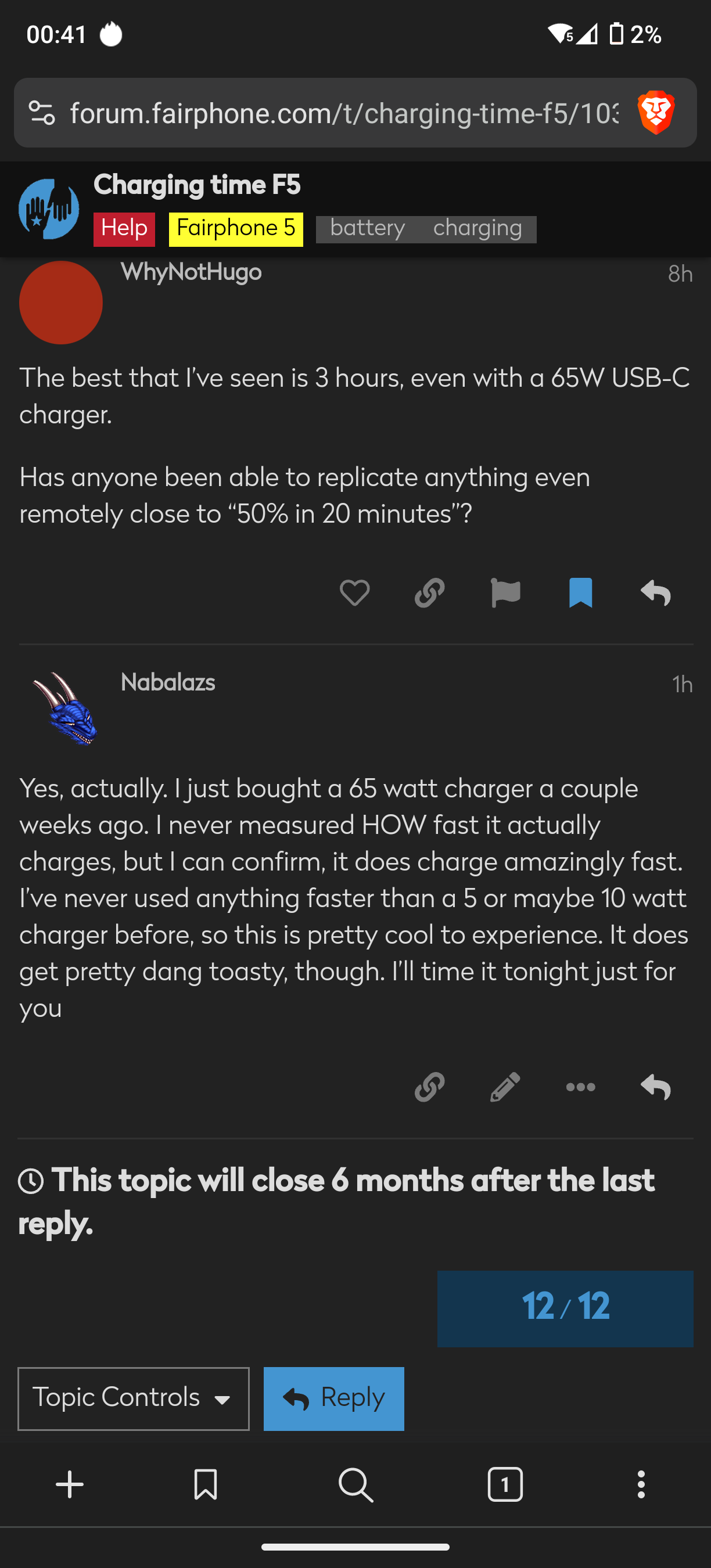

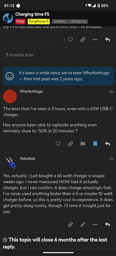

The best that I’ve seen is 3 hours, even with a 65W USB-C charger.
Has anyone been able to replicate anything even remotely close to “50% in 20 minutes”?
Yes, actually. I just bought a 65 watt charger a couple weeks ago. I never measured HOW fast it actually charges, but I can confirm, it does charge amazingly fast. I’ve never used anything faster than a 5 or maybe 10 watt charger before, so this is pretty cool to experience. It does get pretty dang toasty, though. I’ll time it tonight just for you
