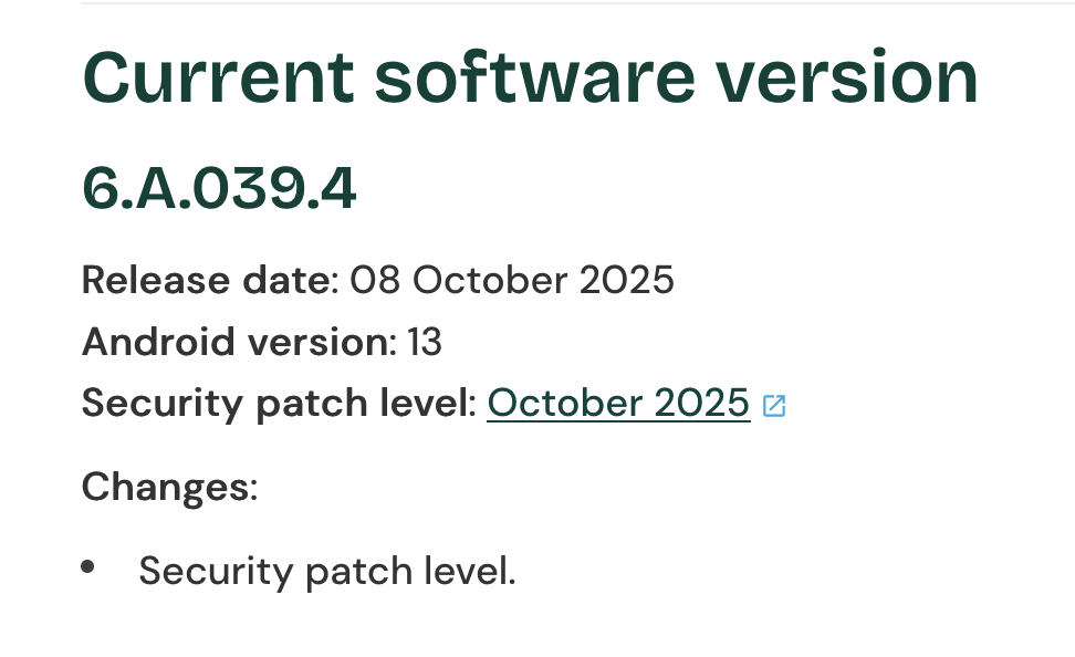

I am at a bit of a loss here, I have been trying to find the 6.A.039.4 fastboot image for the FP3+ to download but cant seem to find a link anywhere? Just want a downloaded copy before I play with e/OS due to the Security Patch level. Thanks

I haven’t installed the lastest OTA as I see the image I can download has the Aug 25 security patch.

My understanding is that if I went to from Stock to e/OS my securty patch level would upgrade from Aug to Sept and to roll back to stock I could use the above image as its Oct 25 patch level.

If this is still relevant, the fastboot image of 6.A.039.4 is showing here now (with – currently – a wrong release date): https://support.fairphone.com/hc/en-us/articles/18896094650513-How-to-manually-install-Android-on-your-Fairphone
You are a star. I checked it earlier today but yeah, its got the wrong date, Thanks for letting me know as I wouldn’t of noticed it!
