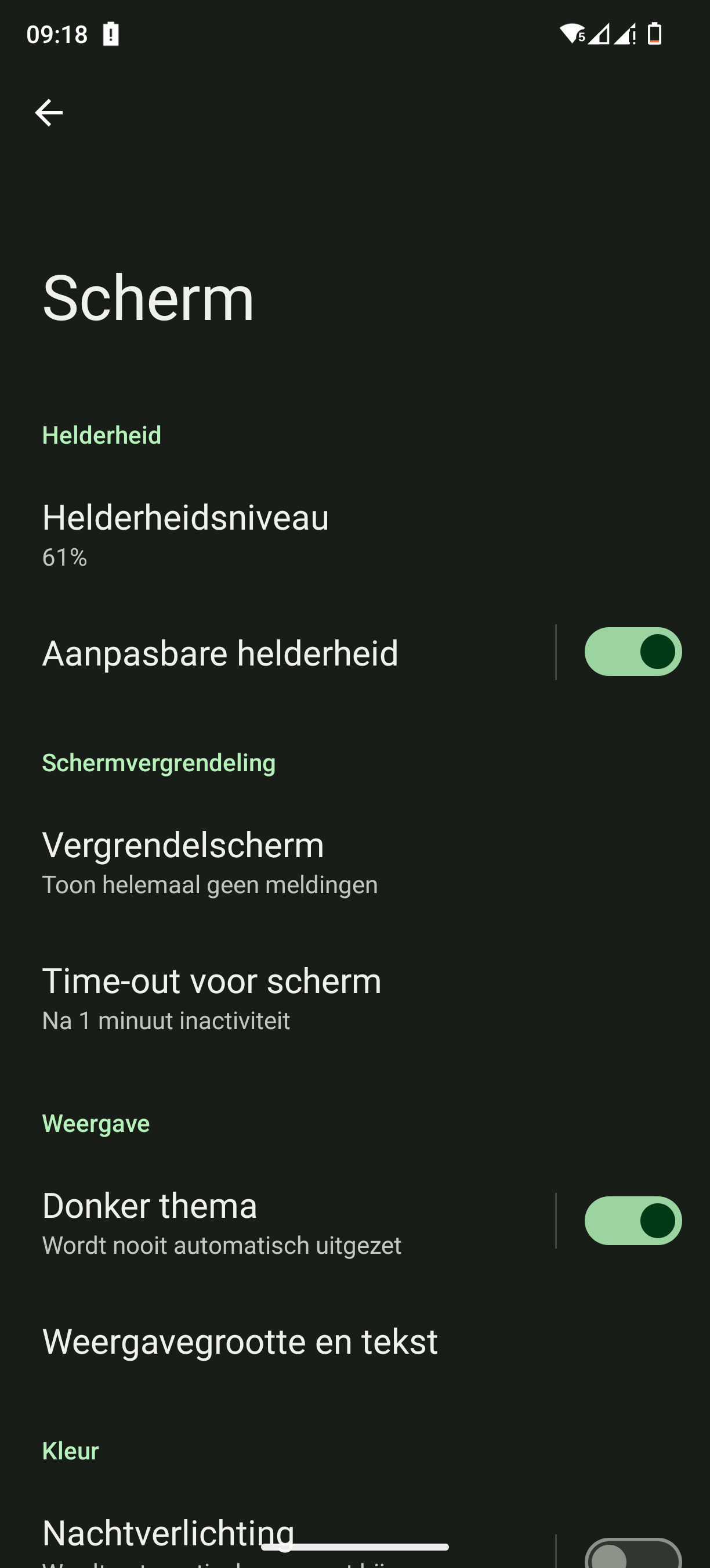

Lowest auto brightness setting:
my phone dit switch back to 61% after unlocking and random during use.
looking around in the setting how not really make themselves clear what tey suppose to do.
i did’t noted a difference when on or off.
i dit mark them blue.
