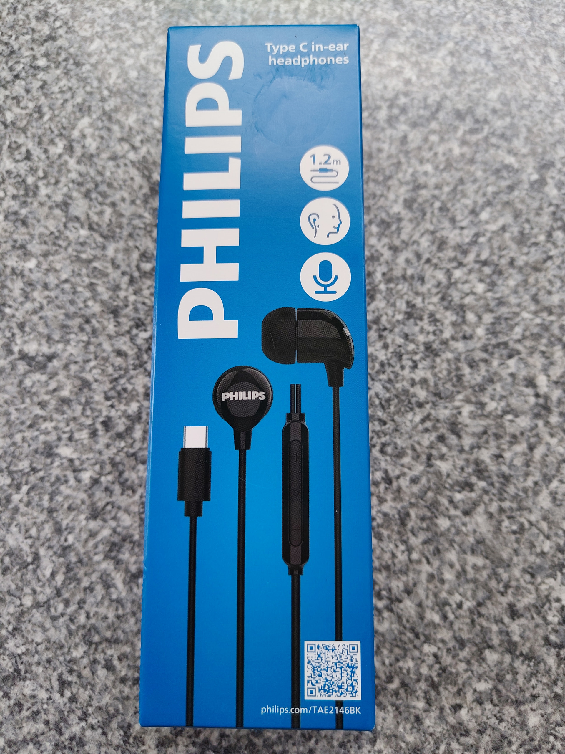

I can confirm that wired earbuds are working fine, depending on the manufscturer of your choice.
I went for those and they work as they should with buttons seem to work as they designed for.
I also tried one of my old skullcandy buds with adapter which worked as well.
Thanks. Someone told me to change a setting in developer mode. Did that and trying it tonight. If that doesnt work I will eiter buy philips usbc or an adapter and buds with jack
Same problem with these Philips ones :disappointed_face:

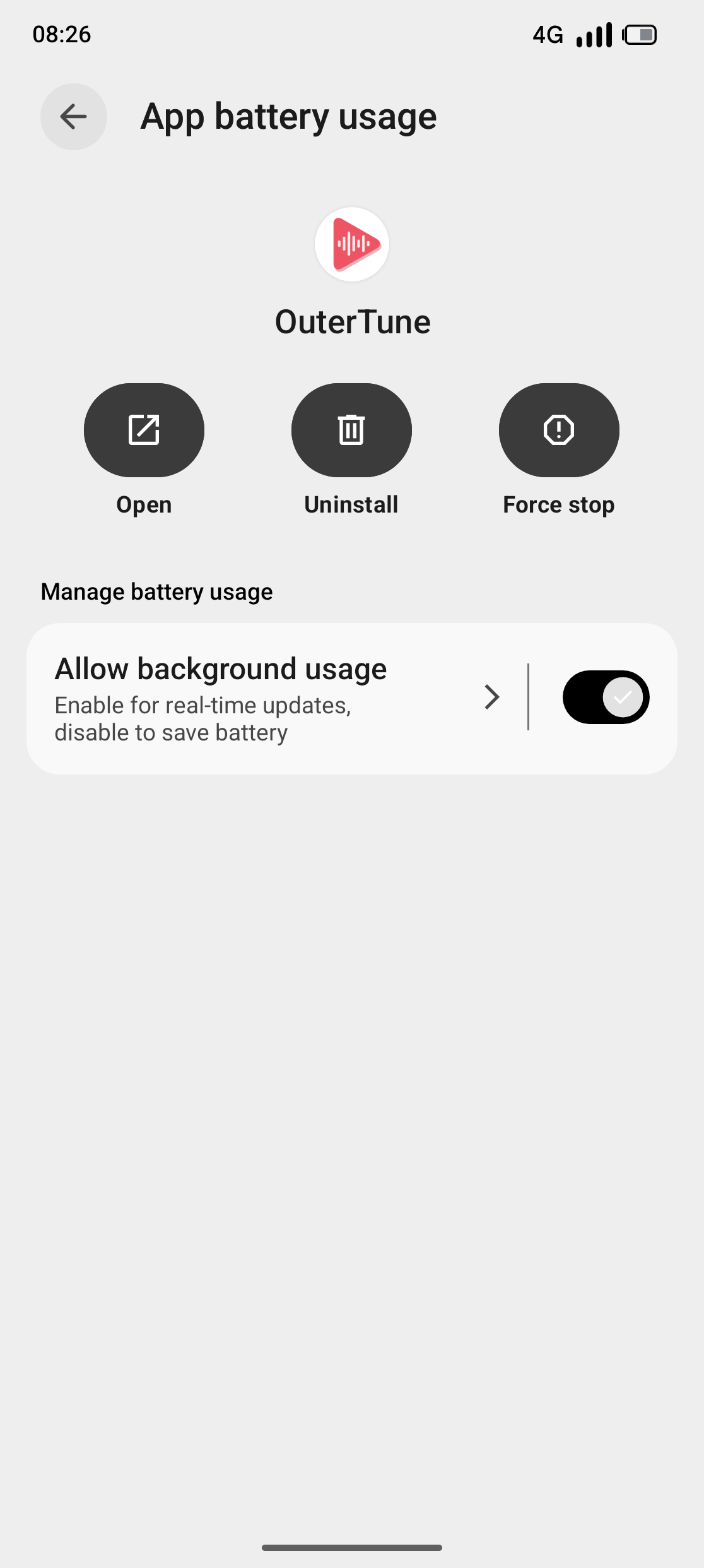

I think it might be your usb port , or a battery optimisation error.
Some setting in android it self is letting the phone go to deep sleep killing all the apps in the background.
Have you noticed how long after connecting headphones and starting playing music this thing happens?
Also it might be that your phone is in the pocket and cable is getting bend resulting in loosing connection.
I usually keep my phone in back pocket when using it for listening to music where cable is not prone to moving a lot. Also when I first used headphones I had to exclude my music app from battery optimisation option so it can run in the background when screen is off
Please make sure if that option is checked in your music app settings.
Hope this solves it as I look like a mug recommending product that does not work for you
No, don’t feel bad. It worked for you so I tried it. We will use those earbuds anyway, my son is prone to wrecking them. It’s not the pocked thing either, the one is on my bedstand and I’m lying down, listening to a meditation. I know what you mean, but that’s nog it. The sound fades of its own accord. It’s almost immediate. And the silences usually get longer the longer I listen.
