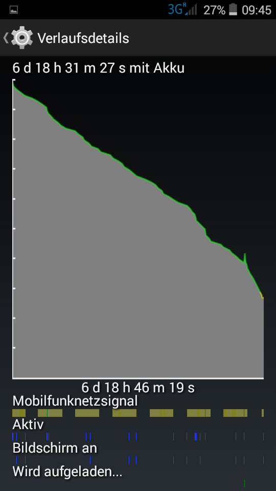

Having struggled to figure out what caused my battery drain under 4.4.4. (see here, here, here, here), I cannot provide 100% certainty about the exact cause now, but I believe I can finally say that I have been able to overcome it. I don’t get record duration out of the battery under 4.4.4 (4.2.2: 10+ days), but the difference is now significantly smaller (20-25% less). My most recent two discharging cycles:
I strongly suspect that starting the original migration not from Jelly Bean (4.2.2), but from Macadamia (4.4.2) to Fairphone z3ntu OS (4.4.4.) is to blame. After numerous cross testing coming from that migration path, I noticed this interesting pattern at one point: While a full battery charge done in the FP1 kept giving me a meagre 3 days battery life at best, battery life was dramatically better (more like what’s it’s now, see above) when the same battery was charged either in a different FP1 or in an external charger. To make sure it wasn’t about an imperfect USB port or any other hardware weakness, I switched back to 4.2.2 and promptly got the previous level of 9-10 days out of the battery again. Eventually, I did give 4.4.4 one final shot, starting directly from Jelly Bean unlike before.
So … I cannot exactly express what caused the drainage, but it strongly seems that something disturbing the charging process under Macadamia might have been carried over in my original migration. It was taking the same time for a full charge as under 4.2.2 and 4.4.4, and yet the battery would discharge much quicker (and btw, also by an unnaturally steady rate going by the battery life graph).
